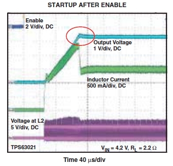

Our customer evaluates the TPS63020EVM. They found a overshoot at startup like the following waveform.
The problem is that the overshoot was larger than below. (The setting voltage is 3.3V. The peak voltage of overshoot is 3.6V)
The condition ; EVM is TPS63020EVM-487. However the Cout is reduced to 22uFx2 from (22uFx3+2.2uF).
                        Vout=3.3V.
Why does this happen? And how can we reduce that overshoot?

  • This phenomena is expected behavior of the device's regulation loop. It changes state once it reaches the target voltage and therefore generates a dynamic control loop behavior.
    Decreasing the capacitance will generate more overshoot.
    Did you enable the device in Power Safe Mode or in FPWM?
