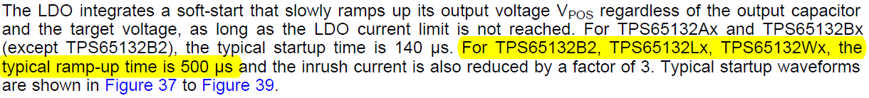

We understand that the startup time of TPS65132Lx is 500us(typ).
However, our customer would like to know the min and max value.
Could you please let us know if you have any information?

    The minimum and maximum startup time is not specified in the datasheet. Is there a specific minimum and maximum value the customer is not allowed to under- or overshoot? What is the reason for the customer asking for this parameter?

    According to customer, they need more than 500us so the startup time must not become less than 500us.
    Because, this specification is demand of the LCD panel(Load device).
    Therefore, they would like to know the minimum value of the startup time.
    Could you please let us know this value?
    This value does not need to be a guarantee.
    Kanemaru
  • Hello Kanemaru-san,
    Do you know if the panel vendor has a reference design with TPS65132 in it? If yes, this would make sure that our part can work with this panel. If not, we need to understand how low the startup time can go. At the moment I do not have a number for the minimum startup time, but will try to get this information. Would you please clarify which voltage on the panel needs the 500us startup time?
