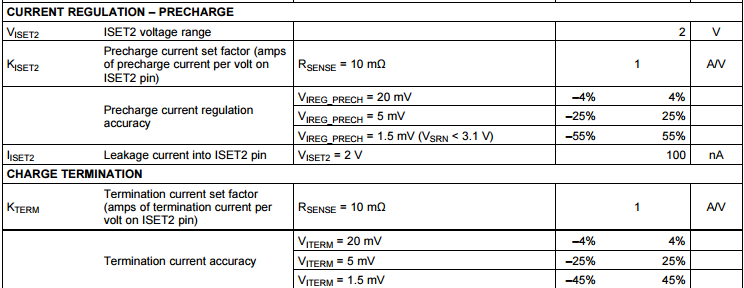

  • The minimum pre-charge and termination current is 125mA for the device. See paragraph below equation (5) in the datasheet (page 17):

    But in case ot VISET2 = 50mV (R16=1.56k), the charging was terminated at around 50mA though IPRECH is clamped. So this means that the termination current can be set lower than 125mA. Now our customer want to set termination current as low as possible, so please let me know if you have any concern for setting termination current lower than 125mA.
    I understand that the recommended minimum current is 125mA for both IPRECH and ITERM, so the accuracy can not be guaranteed at lower setting than 125mA.

    Again I need to know the concern when the IPRECH and ITERM are set lower than 125mA with 10mohm Rsns. I guess that the concern will be...
    - IPRECH will be clamped around 125mA but the accuracy can not be guaranteed.
    - ITERM can be set lower than 125mA but the accuracy can not be guaranteed.
    Sonoki
  • Satoshi-san,
    I have confirmed that the termination current can be lower than 125mA, so the 50mA that the customer is observing is feasible. But as you pointed out, we cannot guarantee the pre-charge current and termination current lower than 150mA (with a 10mOhm sense resistor).
