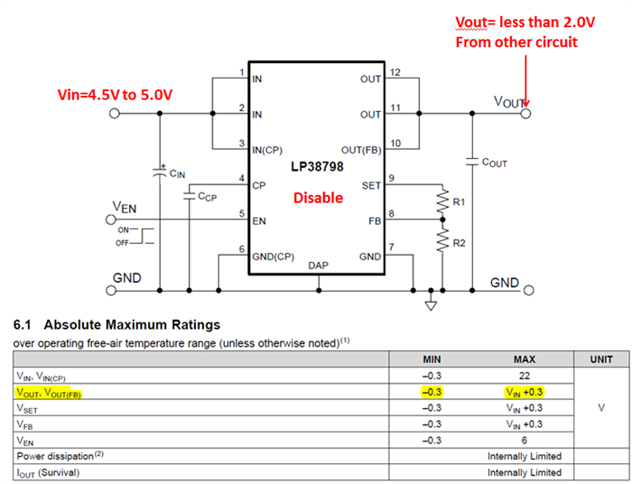

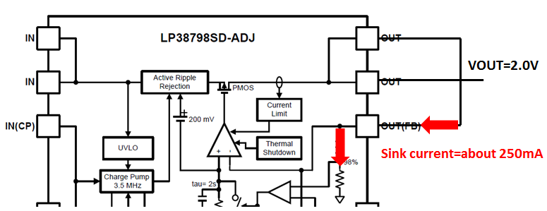

Hi Team,
They would like to apply the external less than 2.0V to the out pin when this device is disabled, Vin=4.5V to 5.0V.
I understand that they can apply this voltage to the out pin because this voltage doesn’t exceed the absolute maximum.
Could you please let us know if you have any concern?
