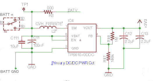

I'm using 2 x AA cells to power a small cct with two loads (processor and another chip) via the 61070, pretty much following the spec's reference cct/values.
Using a 10uF tantalum input cap with a .1uF ceramic in parallel, a 4.7uH input inductor, and then for the output caps 2 x 4.7uF ceramic (0805).  The circuit is set up for 3.3V.  With just my processor loading it, it draws less than 10mA, and seems to manage 3.3V okay.  But I had to isolate the second chip to get to this point.  The second chip wants about 100mA to start then will settle to 30 or 40mA in a few seconds, but the 61070 doesn't seem to want to allow that.

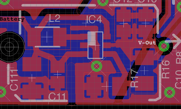

My layout SEEMS to be following the guidelines. The output caps are about 2mm from VOUT pin. The resistor divider, perhaps 3.5mm from FB-pin.

    3. Will try to share of the schematic/layout of that section. Hope those come thru.
  • Oops - in that schematic, the C12 and C13 values are actually both 4.7uF ceramic caps.
    C111 - is a 10uF tantalum, and C11 is 100nF ceramic.

    2. what is the part number of inductor. i worry if the inductor is saturated.
    3. if you re-layout PCB next time, please place more vias beside the GND pin of the TPS61070 and output capacitor.
  • The inductor is a Bourns CVH252009-4R7M. It is a 4.7uH monolithic rated 1.1A and in a 1008 size.  Do you think more inductance there would be helpful? I'll explore that.

  • 1. The inductor is good. it is not the reason of the failure.
    2. please try to increase the output capacitor.

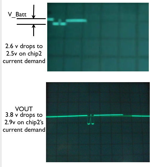

    To clarify - I've adjusted the circuit now to give 3.8Volts out.  For Chip2 I am using an LDO to regulate down from 3.8V to 3.0V. When I add the load of chip2 to the 61070 output, the output holds still at 3.8V.   Chip2 tries then to pull higher current for short periods of time, then the 61070 output drops, thus LDO does also.
    Here is a scope view - VBatt drops only a little, from 2.6 to 2.5V with that current demand (picture is a bit blurry, sorry)  The VOUT goes from 3.8V to 2.9V.  Sorry, my scope is not very fancy.
    I've tried 30, 50 and even 100uF extremes on input and output capacitors, but the size and shape of the voltage dip does not change.

  • hi Ross
    1. does the VOUT is measured at the output pin of the C12? if not, please test the VOUT at the COUT node (near the IC). i want to make sure if the voltage drop is caused by the TPS61070.

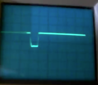

  • 1. Yes, VOUT measured right at the pin, and at the C12 pad are the same. Here's a pic where I'm getting 4V out, and it drops by 1.5V each time my second load tries to draw current.   Without the load added it provides a solid 4V at 20mA in my current bias setup.
    I tried substituting a different LDO to manage the 2nd load, regulating down 61070 output back down to 3V. The new LDO is rated for 600mA and but there is no difference, so I don't think it was the the LDO's fault.
    If I replace the 61070 with 3batteries at 4.5V the LDO works fine. Or even two fresh batteries at 3.2V - the LDO is able to get its 150mA or so without any problem. So it's the 61070 unable to provide current enough.
    2. The load is electronic - a WiFi module.  I'm not able to slowly increase the load with that, and anyways my ability to capture wave forms at transition is not very good with the oscilloscope I have (no storage function).
    My only assumption now (since I've played with all the component values) is that the layout is not good.  I see there is a NEW TPS61070 datasheet since I downloaded my copy in the spring - and it shows a recommended layout now.   I've used that for a new board layout and so I'll have to make a new board.  If that proves STILL unable to provide the current I need I will have to probably abandon the 61070 and so yet another board re-work. :(   Very time consuming.
  • 1. Could you measure the waveform of SW pin? zoom in to observe if the device switches at 1.2MHz. and also measure the current of the inductor if you have a current probe.
    2. please use a strong wire connecting COUT GND PAD to TPS61070 GND PIN.
    3. does you have some power resistor? connect to the output of TPS61070 to simulate the real load. so we will know if the TPS61070 can stabilize the VOUT at 100mA or 200mA.
