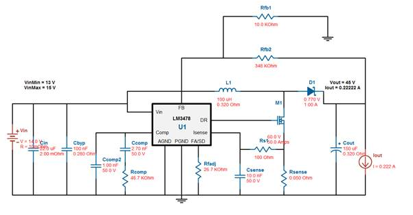

Hello everyone,
I'm having problems designing a compensation circuit.
I've been working on designing a power supply that delivers 45V at 0.2222A from a 14V source with this basic layout:
I initially tried out a webench design with a 100uH inductor, but am forced to use a 6.8uH inductor due to size constraints.
the other relevant component values:
Fs= 981 kHz
Cout=100uF (ESR at 100kHz = 28mOhm)
Rsn=0.07 Ohm

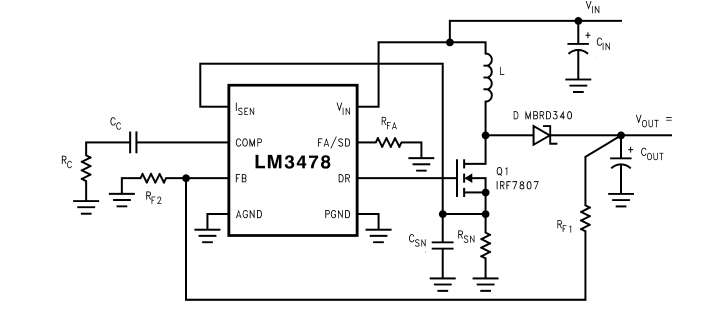

I've been using this Application Report to design the compensation circuit and when I try to compensate for the poles and zeroes I get rather strange values for Rc (14.47Mohm!) and Cc (13.8nF).
Am I missing something?
