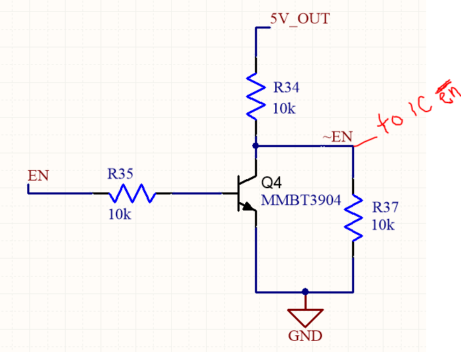

  • Thanks Alek. I have another question regarding this device: Page 7, of the datasheet SLUSAR6D, states for the EN pin the following "Because high impedance pullup and or down resistors are used to reduce current draw, any external FET controlling this pin must be low leakage."
    What does exactly "low leakage" means? Maybe it is a newbie question but I am not sure what is the maximum input current or the minimum output impedance of the driver should be to drive the EN pin. Actually,  the device is being driven by a BJT inverter (using an mmbt3904) with some resistors:
    So I would like your guidance as to how to design the driver circuit for this pin and to now if the current driver would work or how should it be modified.

  • Hello Juan,
    I am sorry , I missed your other question in the discussion,
    /EN is pulled to VIN by a 10-MΩ resistor, pulled to GND by 16.8 MΩ, and this was basically done to reduce current draw in the IC,
    Now if you use any external FET/BJT circuit connected which has lower impedance (in Off state ), that may give undesirable lower voltage at /EN pin and that it may be treated as the device disable input , which will turn off the device.
    Now to comment your circuit , since you have used strong pull up (R34) and pull down(R37), with external BJT, you should be fine with it, I mean that will not give any undesirable input to the /EN pin.
