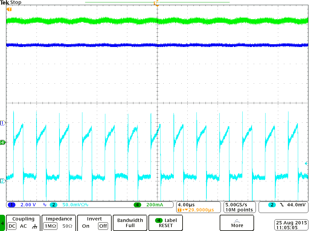

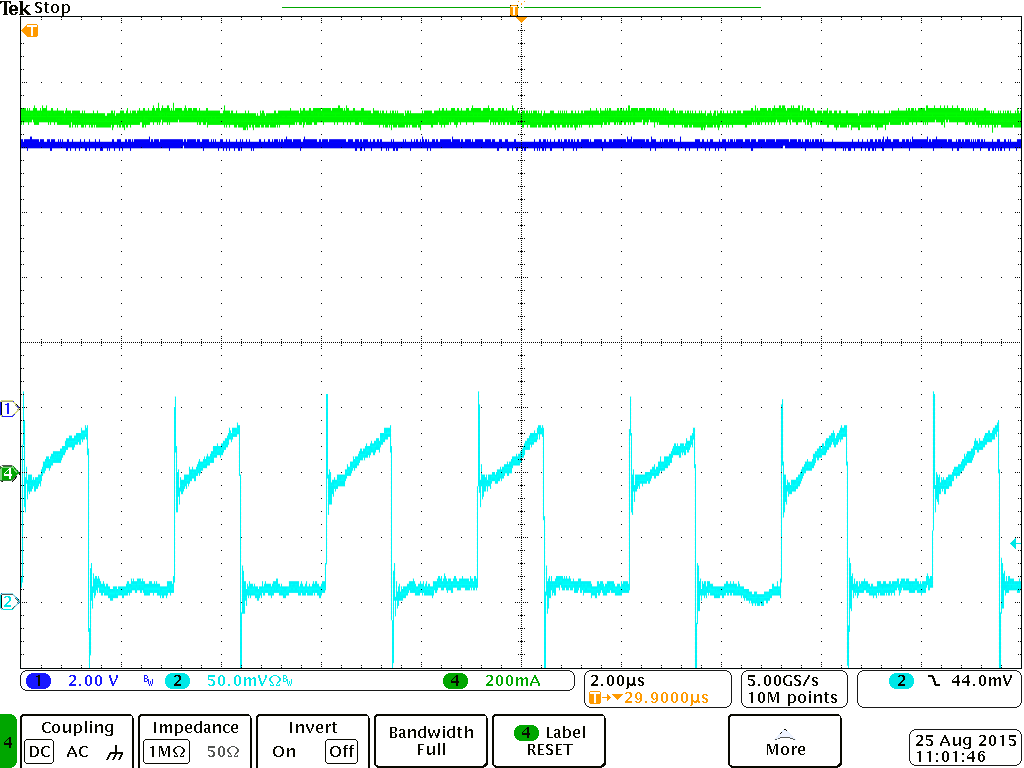

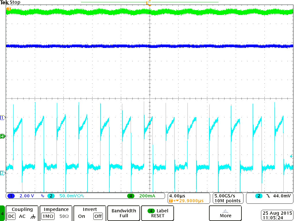

  • Hi Shrikant,
    I have built a similar system using a modified eval board. 6.8uH, 8Vout, 50mohm sense resistor.
    I measured the output beginning to drop at 1.25A output current and 0.55A at 3Vin which is close to the estimate I have.
    When the parts is current limiting the part will not shutdown, it will simply limit its peak current each cycle so what you should observe is the output voltage gradually drop as you increase the output current beyond the set current limit.
    The following captures show in green the output current, in dark blue the output voltage and in light blue (cyan) the voltage across the current sense resistor.
    You can see that the voltage stays at 8V as the current is increased (first two screenshots). But above 1.25A (last screenshot) the output voltage begins to drop as the current limit prevents the system from delivering enough current to keep the output voltage at the desired level.
    Florent
