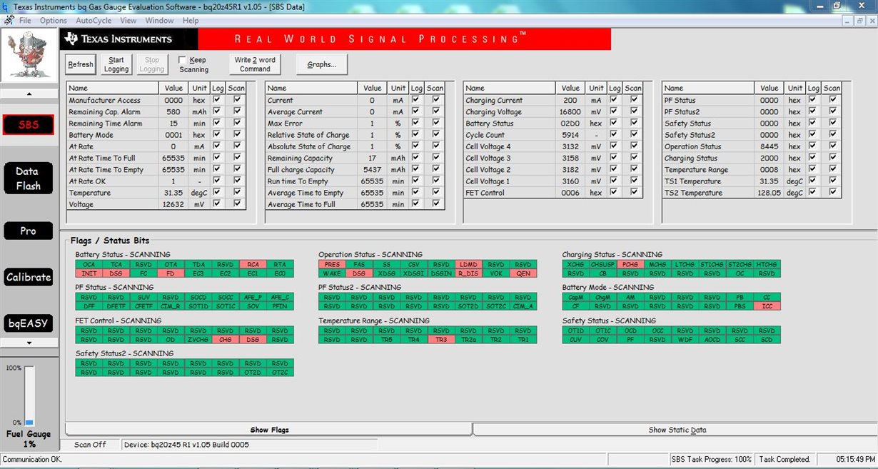

    In addition to this, we would also like to raise another incident where we lost the INIT bit on a different battery pack. The current set up of our testing is that the charger and the EV kit are both connected to the battery pack.
    First I changed the DataFlash for TCA Clear %, then after changing I confirmed that INIT bit is still ON. After that, I removed the connector of the charger from the battery pack because I needed to change the charger cut-off from 0.01C to 0.05C. Then when I reconnected the charger, the INIT bit was OFF. I do not understand what exactly caused the INIT bit to disappear. Please kindly help us to understand the INIT bit concept. Would connection problem cause INIT bit to disappear? Then I also noticed that the cycle count went up to a very high number (5900+) which is an unrealistic number since the battery pack has not undergone such number of cycles. I noticed that this is a common occurrence whenever we lose the INIT bit. The cycle count rises to a very high number. Aside from the cycle count being affected, would there be any other abnormalities on the fuel gauging and functionality of the IC? Below is a screen shot of the SBS of no INIT bit however I cannot attach the SENC file.
