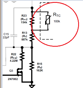

Hi Forum,
I was implementing the SLVA437 ,
But I face the problem that my application doest use a RTC resistor indicated as follow
So I planned on use an equivalent resistor with the parallel resistors  [R_PT || R_TC + RT], of course once RT is calculated. As follow
So my question is, Will this modification affect in any case the target Pulse Charge Algorithm? If not please advise, If yes please help me to correct the circuit so no RTC resistor is used. If I dont use it and use RTC as 0, some of the equations operands will be 0.
