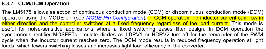

Customer is trying to use the following specification LM5175.
・Vin=12V to 24V
・Vout=16V(variable plan)
・Iout=5A
・Customer want to sink and source operation(inductor current).
In this case,I get the following questions from a customer.
◇Customer question
The following description is present in the data sheet.
Should you use the CCM mode in order to the Sink and source operation?
