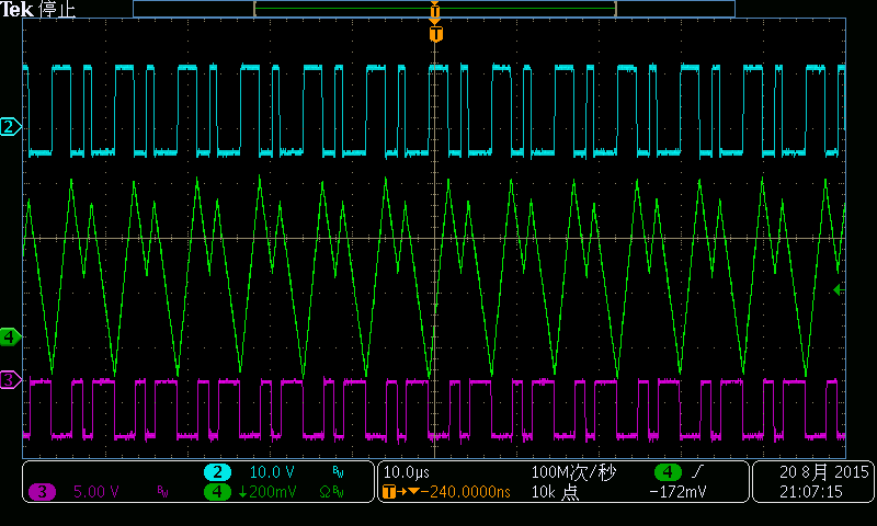

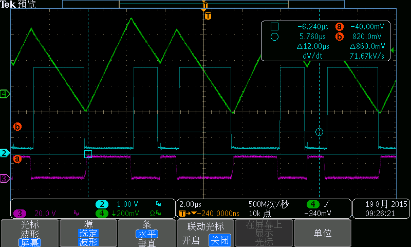

I meet some problem when I use LM5116 for 12V to 5V converter. I add a 10KΩ resistance between DEMB PIN to GND.
When Iout =0.5A  LM5116 works well . But I gradually reduce the output current when the IC works in FCCM mode the the current is strange.there is a transition in L current's falling.
Can you give me some advice to remove it ?

  • Hi Carry
    Are you using clock synchronization?
    What is the purple waveform?
    EL

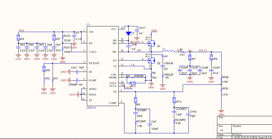

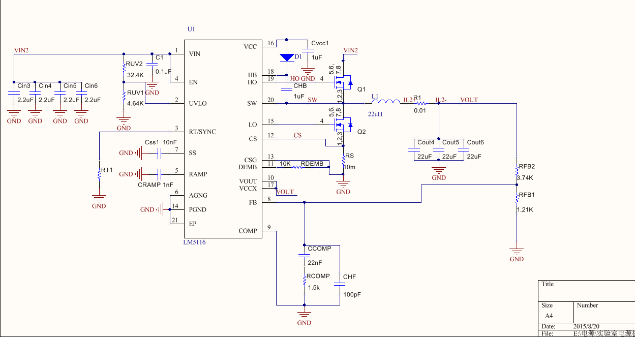

  • Hi EL
    I am not using clock synchronization.
    this is the schematic
    the purple waveform is LO PIN and the blue waveform is HO PIN.

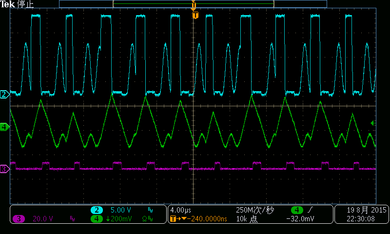

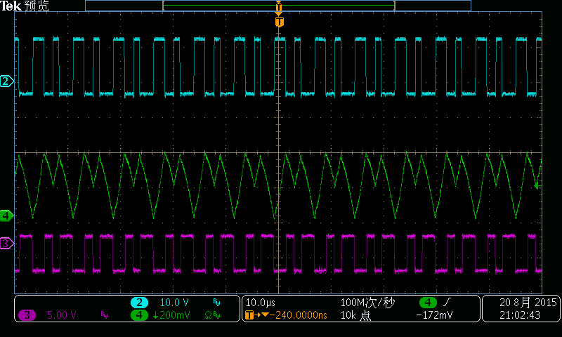

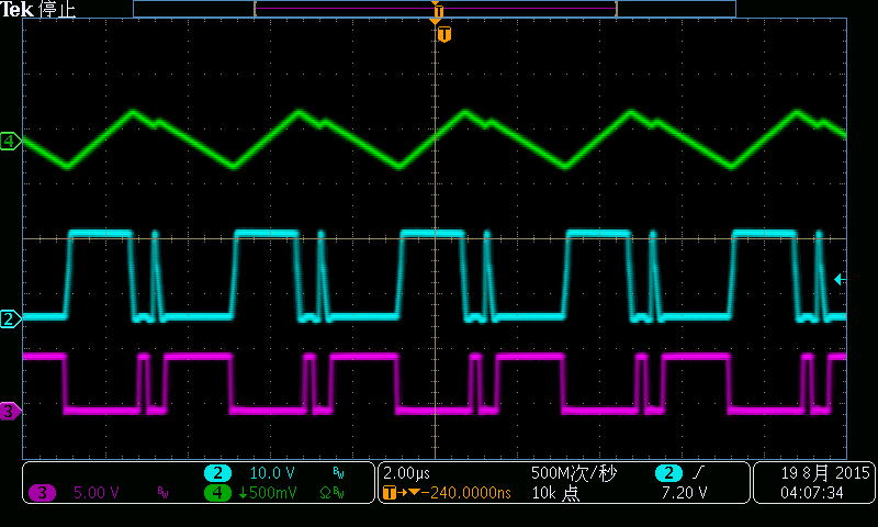

  • Hi EL
    I take the detail about last picture

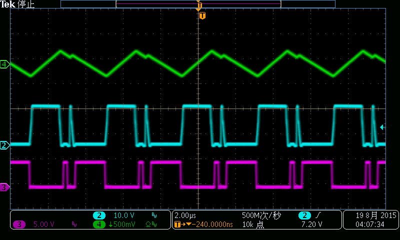

    In addition
    I try to connect DEMB to GND directly. In principle, LM5116 would  always run in diode emulation. But I find LO pin turn on sometimes.and the HO PIN output is also strange.
    Channel  2 is HO pin
    Channel 3 is LO PIN
    Channel 4 is Current in L
    I wash there are having some useful information for you
    Carry

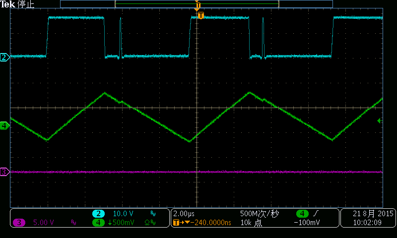

  • Hi EL
    I use
    Cramp = 560pF
    Ccomp = 15nF
    Rcomp = 4.8K
    Chf = 150pF
    but the condition is even worse.
    later I use
    Cramp = 1nF
    Ccomp = 15nF
    Rcomp = 4.8K
    Chf = 150pF
    the flowing is wave
    and I use
    Cramp = 1.5nF
    Ccomp = 15nF
    Rcomp = 4.8K
    Chf = 150pF
    I ddid not connect Channel 2
    if I use
    Cramp = 2.2nF
    Ccomp = 15nF
    Rcomp = 4.8K
    Chf = 150pF
    the wave didn't  stabe

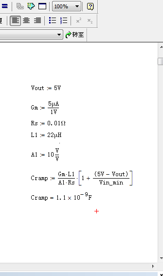

    I use Mathcad to calculate the Cramp
    am I right?
    Ragards
    Carry

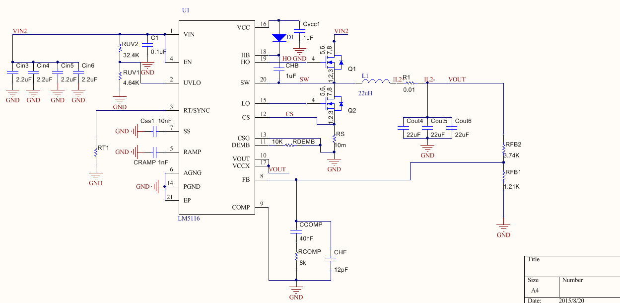

  • Hi Carry
    My colleague found that you connected COMP to ground. COMP should be connected only to compensation components.
    EL
  • Hi EL
    I am so sorry about that I made a mistake. the COMP doesn't connect to GND. Because there are a lot of jumper in Schematic ,So I remove it for intuition. And I
    add GND to COMP uncarefully.
    it's the original schematic
    JP4 short ; JP5 open ; JP6 open ; JP7 short ; JP8 open ; JP9 short ; JP10 open  ; JP12 open
    I am so sorry about wasting your valuable time because of my carelessness
