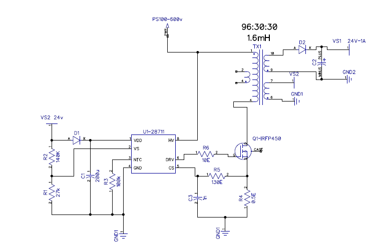

We have a problem with UCC28711, it is not power up at all. We changed the IC, We changed the MOSFET and did everything. Still it is not Producing any pulses.

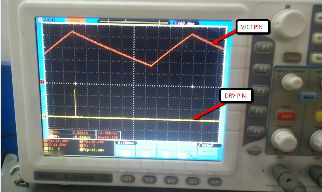

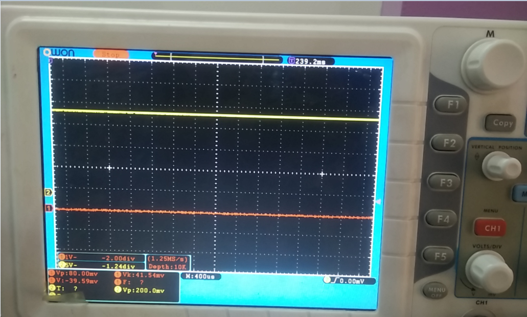

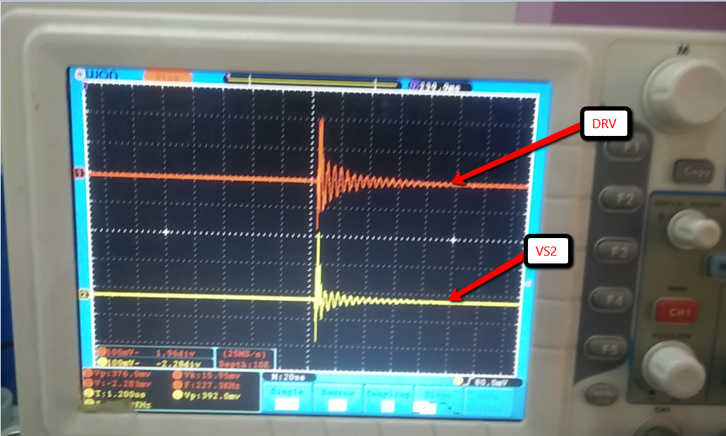

We saw a strange behavior in NTC pin. Please find the attached waveforms.
Red: NTC Pin ( 100K connected between NTC and GND, note that NTC Pin is going to 20mv and going to zero)
Yellow: VDD Pin
