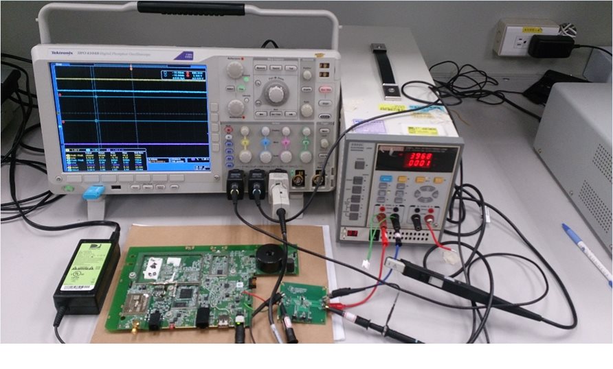

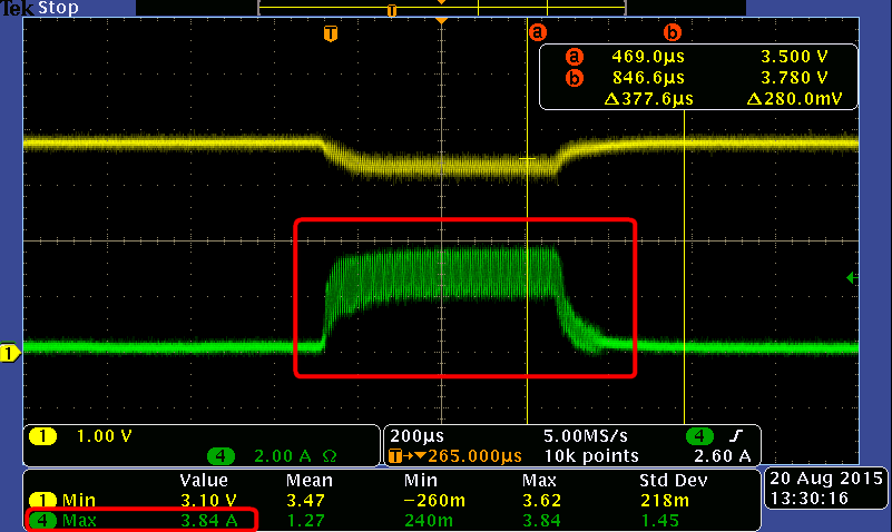

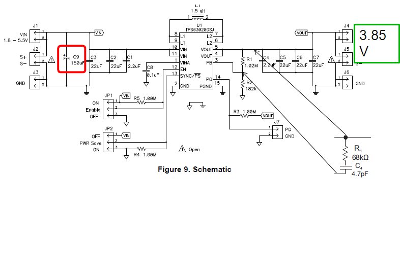

Our customer used TPS63020 as their design solution and they found the current oscillation when test transient response. Does anyone can help provide some solutions to solve this problem?thanks ~
