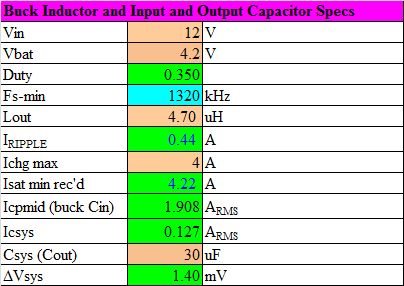

Hi Everyone,
I understand that bq25892 integrate type III compensation network so there is limitation to choose LC component value. I found that you recommend 1-μH and minimum of 20-μF output capacitor in datasheet. Now I'd like to know the limitation when other inductor value will be used. Actually our customer plan to use with following values that is designed by bq2859x calculation tool.
Your comment will be appreciated.
