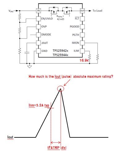

My customer has question about TPS25944A.
Could you tell us about question?
[Question]
How much is the Iout(pulse) maximum absolute rating?
Please see figure below.

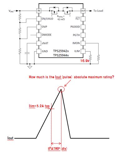

[Question]

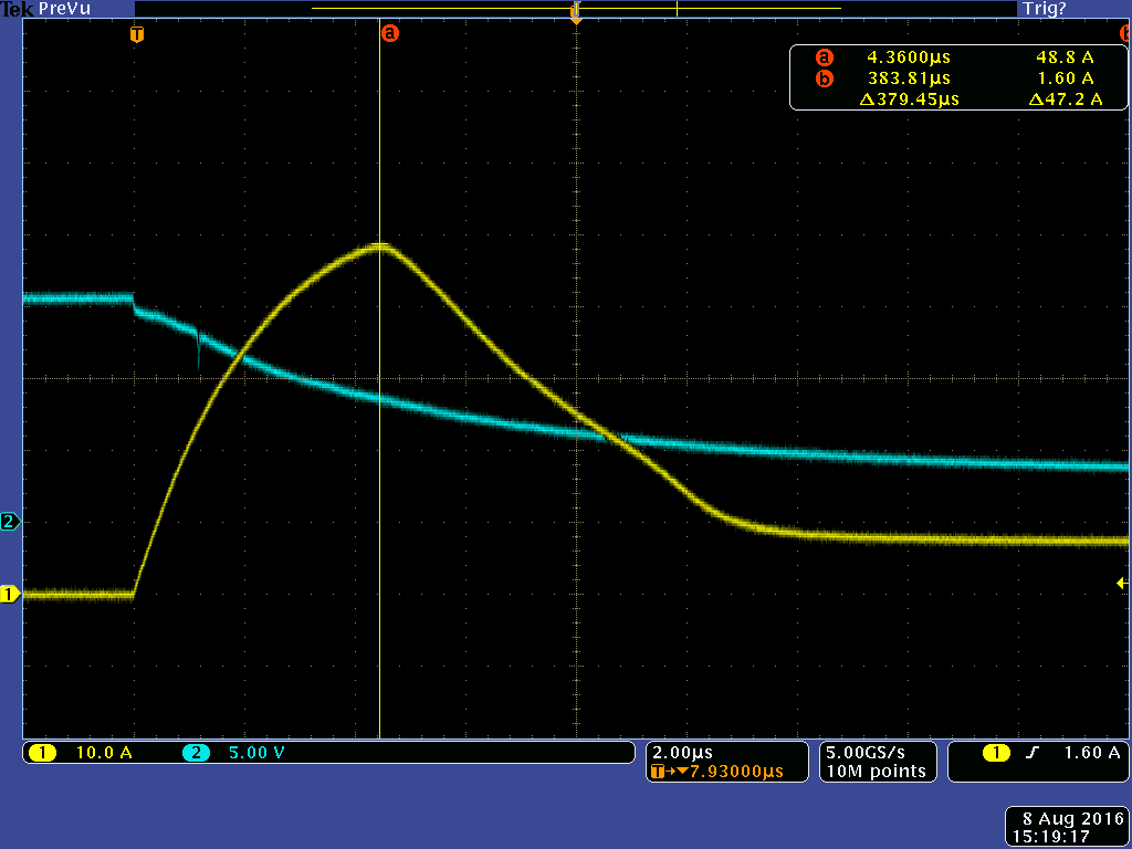

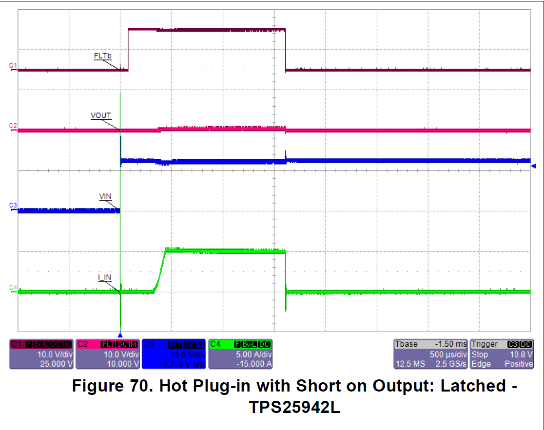

Hi Tateo,
The peak current through TPS25944 during the output hot- short is limited by the path parasitics (Resistance and inductance) of input supply, chip, short circuit parasitics. The current peaks only till 200nsec of fast trip time and under all practical test conditions, there will not be any reliability issue with such a fast response time.
Dilip
