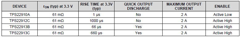

Aside from the addition of quick output discharge and a slightly faster rise time, are there any other notable differences between TPS22912C and TPS22913C?
Jonathan
Jonathan
Hi Jonathan,
Aside from the rise time difference and QOD, the TPS22912C and TPS22913C have the same specs and features.
