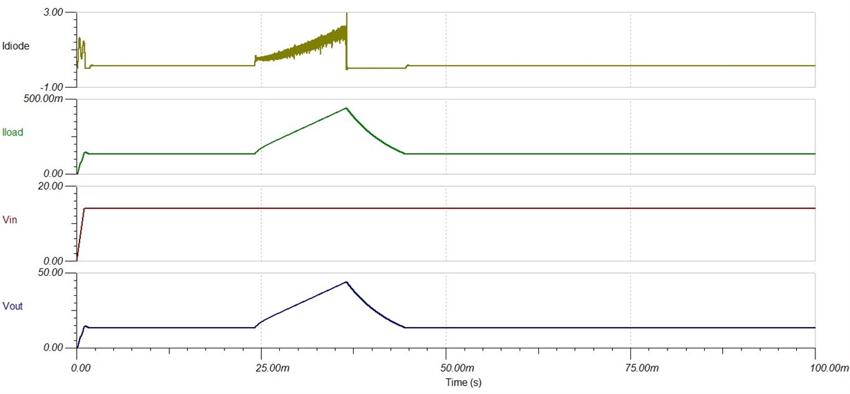

Is it possible or make sense to try to get 150W output with TPS40210 boost topology from 12to24VDC input?
I calculated the needed inductor, capacitor etc. values as below:
Fsw 200 kHz
Ct 220 pF
Rt 378,4438 kOhm
Vfd 0,5
Duty Min 0,80083
Duty Max 0,900415
Lmin 4,91E-05 H 49,07735 uH
ILrms 11,44963 A
ILpeak  13,60457 A
Cout > 9,36E-05 F 93,64315 uF
Cout ESR < 0,035556 Ohm 35,55589 mOhm
Cın > 1,38E-05 F 13,76014 uF
Cin ESR < 0,045421 Ohm 45,42105 mOhm
VFB 0,7 V
RFB 221000 Ohm
RBIAS 1296,731 Ohm
I also tried 50kHz switching freq and matching values but I got same results.I could not be succedded with these calculations and Webench suggested FET-Diodes. I imported the BSC190N15NS3_L1 FET and DFLS12000 diode as macro. Schematic and simulation results are attached as "TPS40210 Booster - Calculated". What does it trying to tell when it drops?
TPS40210 Booster - Calculated.TSC

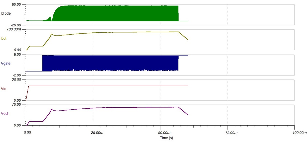

Then I searched on forum and used links below. Especially on forum page, Brit's generic models for FET and diodes gave results. But when I tried to configure for my needs, again it gave strange results again. Experimental simulation and results are attached as "TPS40210 Booster - Experimental".
TPS40210 Booster -Experimental.TSC
e2e.ti.com/.../290035
www.ti.com/.../slur609.pdf
Something is wrong with them but what, I don't know. Maybe, the starting point is wrong.
Could anybody help please? I dont want to work with flyback design if it is possible due to the efficiency and dummy load needs. Boost solution would be very cheerful.
