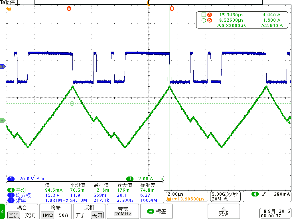

  My customer has designed a prototype using LM5175. Spec is  6~42V input, 14.8V/3A output for car infotainment. But they met an unstable behavior in certain operating points.
  When Vin=30V,Vout=14.8V/1A, system operates normally(Blue line is SW, green line is Inductor current):

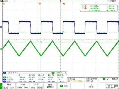

  When load is increased to 1.5A, system is getting unstable:

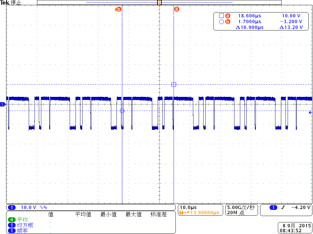

  It gets worse as load continues to increase, Iout=2.3A:
  I modified the compensation network, but it seems no help. I also confirmed the driving signals are ok.

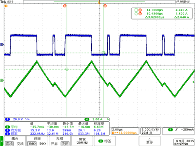

  Also, similar behavior is detected on our EVM, when Vin=15V, Vout=12V/2A:
  SW node:

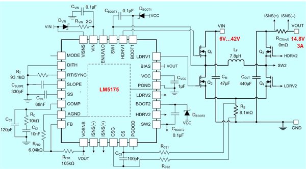

  Customer used our quick-start tool to design, the parameter is as below:
Could you please help take a look at the waveforms and give me some feedback? Thanks!
