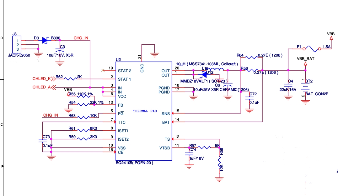

We are using BQ24105 for charging 3-cell Li-ion battery pack.
Now the units are deployed in field. BQ IC is getting burnt at 13(FB pin) and 14th(BAT pin) pins of the IC.
Total reported burnt IC in field are 30 nos.
At FB pin a resistor divider of 110K and 22K (ground)  are used.
We have been long using the same chargers.
Charger input is 15.10V to 15.30V (MAX)

  • Could you provide a schematic of your application?

    Voltage output from adapters is 15.10V to 15.30V  with maximum current of 1A.
    Following is the circuit diagram.
  • Hi, We are facing a similar issue. The ICs simply burn out. We analysed further and put a scope probe between PGND and OUT pin. IN certain cases we saw pulses as high as 20V and in others it was 16V max. 20V is the max source drain voltage.

  • Noticed a very interesting fact. We had two lots of devices- one from an authorised distributor bearing a mark 6EJ in the lot code and another 28W in the lot code. The devices in the 6EJ lot did not give any ringing at PFET turn off point whereas the other lot had a large ringing. changing TVS and inductor values seemed to have no effect on this. Device frequency was 1.1Mhz, well within the 10% tolerance limits defined.
    On the same board when we put the 6EJ series of devices, the peak to peak voltage on the OUT pint remained within 16V max. IN contrast the 28W lot code devices showed a peak to peak voltage of 21V on the OUT pin. Clearly, the internal PFET rating was exceeded. Reducing the I-output had no impact on the Pk to Pk current.
    Further, the pk to Pk on OUT pin is related to the V-IN, which in our case is 14.2V.
    My suggestion- check your source. We are ordering some urgent samples online from a distributor. Will keep you posted on the new lot.
    But our premise is that we were playing with fakes.
  • Hi Pawan,
     We have checked input to BQ24105 its bit higher @15.5 volts so we reduced it to 14.2 volts. Then it got solved.
