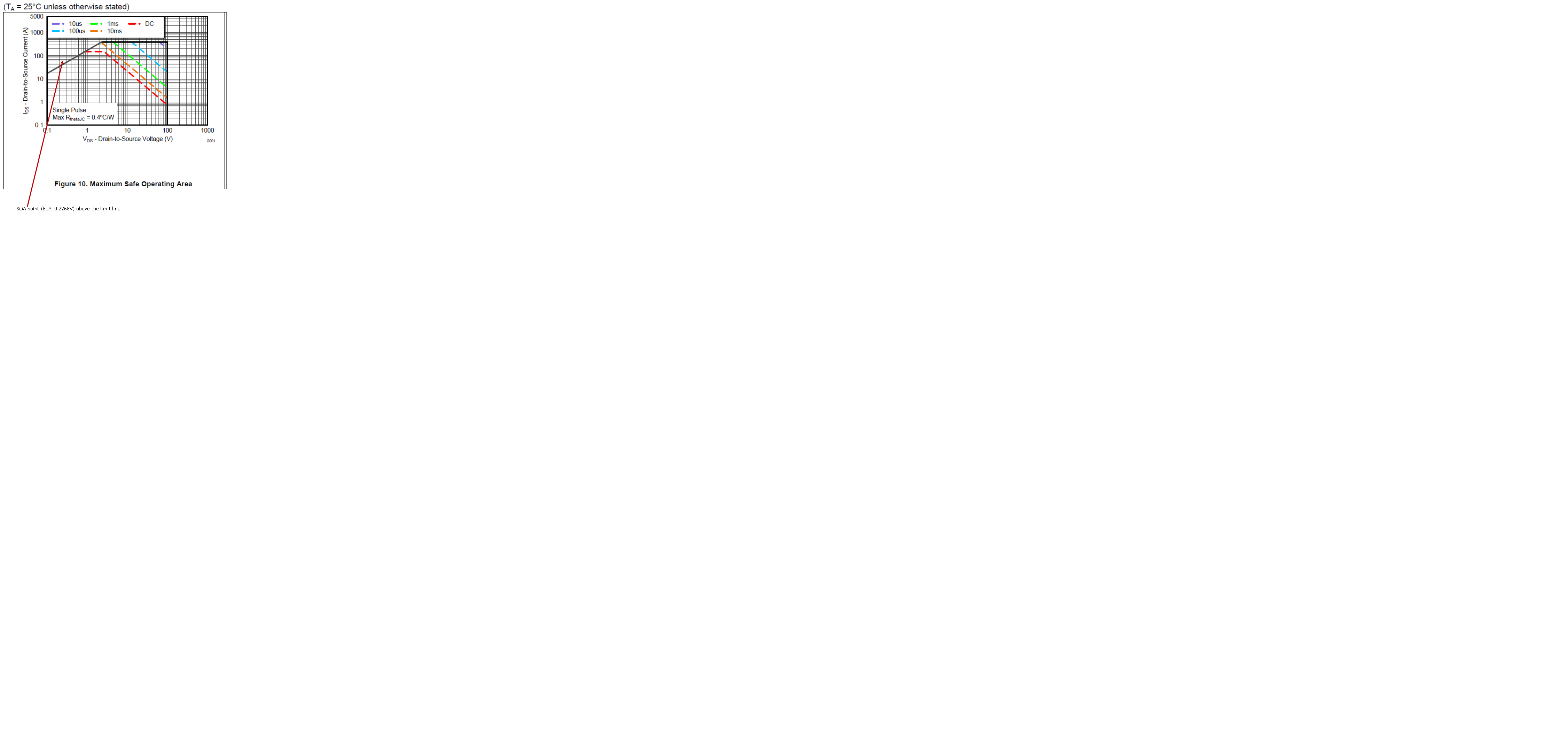

I am using MOSFET “CSD19536KCS” for my Motor drive Project.
Currently I am trying to find out SOA of MOSFET for my application.
Specs & Calculations:
Drain Current Ids: 60A
Max Tj = 85 Degree C (To be maintained)
Rds. ON max = 1.4*2.7 m Ohms = 3.78 m Ohms (from datasheet normalized Rds. ON curve figure.8)
So, Vds = 60*3.78 m= 0.2268V
If I mark these Ids (60A) and Vds (0.2268) values in SOA graph, SOA point is going above the Rds ON limit line. (see attached image)
I understood that, datasheet Rds ON limit line is drawn for Rds ON@Tj=175 Degree C. (Which is nearly 2.15*2.7m Ohms=5.80 m Ohms).
But how do I explain my self whether my MOSFET is in SOA or not , as SOA point is above the limit line?? Kindly explain.

  • Hello ,
    I have missed to mention one important Input parameter. That is Vgs.
    gate to source Voltage Vgs= 10V. (I want operate MOSFET in saturation/fully ON mode )
    Kindly clarify. Your inputs would help me a lot to proceed further.
    Govind.
  • Govind,
    The SOA is a check to make sure you are operating within its confines when the MOSFET is operating in the linear region. The Rdson line limitation is taken from what the current will be limitted to when the Rdson is at its max possible value, at the maximum allowable temperature of the FET.
    So even though you are outside the SOA, if you keep the junction temperature to 85deg, you should be fine. Eventually, the amount of current you can push through the FET when fully enhanced will saturate, but for the CSD19536KCS, this will be much greater than 60A.
    All that to say, if you ensure that Tj = 85, you should have no problem operating at 60A.
    A better figure to refer to for your question would be figure 10. By maintaining the case at 85deg (I'm not actually sure how you could gaurantee you were maintaining the junction at 85), you should be well within the current limits of the device.
