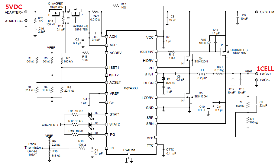

Designing with BQ24630.
but there is uncertain parameter..
Can I Use BQ24630 with 5VDC Power Supply??
REGN is 6V LDO.  But Main Supply is 5VDC.
Maybe REGN Output Voltage will be 4V~4.9V
Is it Possible Charging Condition??

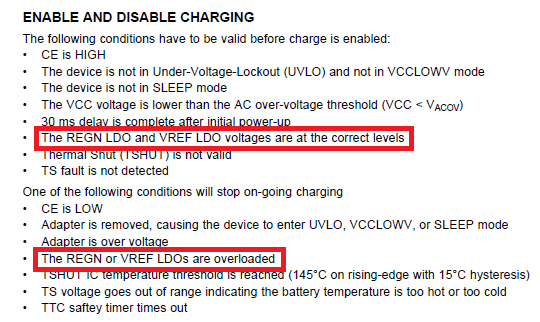

REGN Abnormal Condition Detecting Method is
Voltage Detect?? or Current Detect??
Please Refer page16@datasheet
