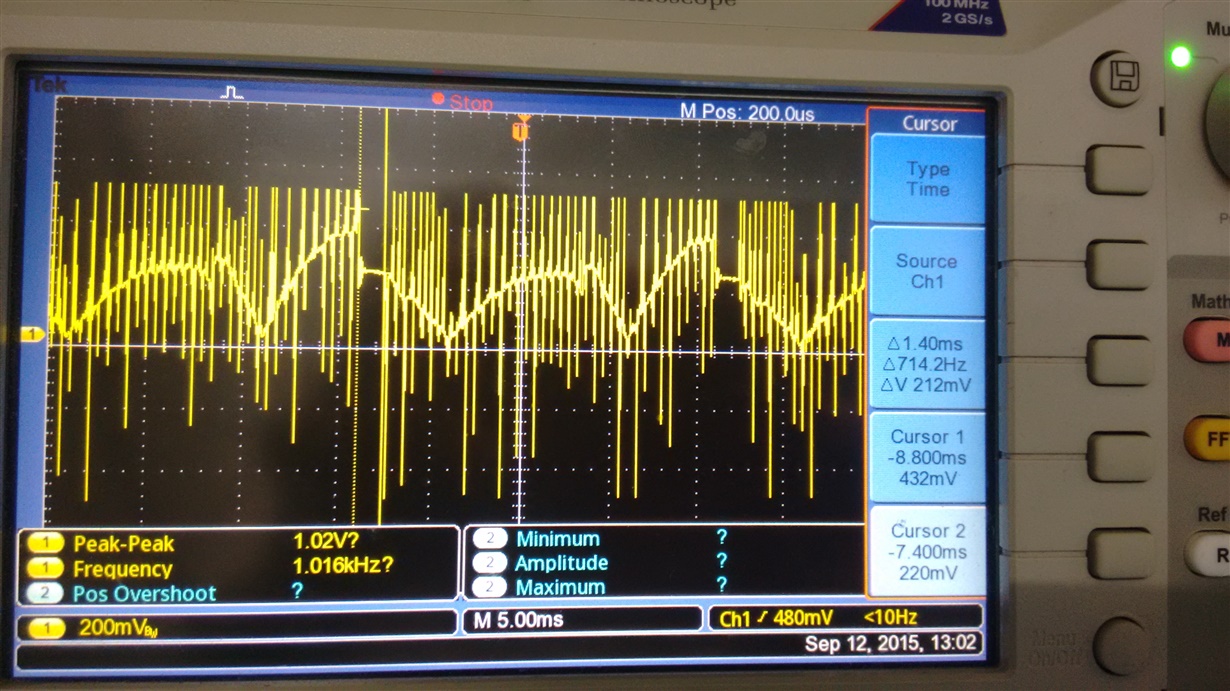

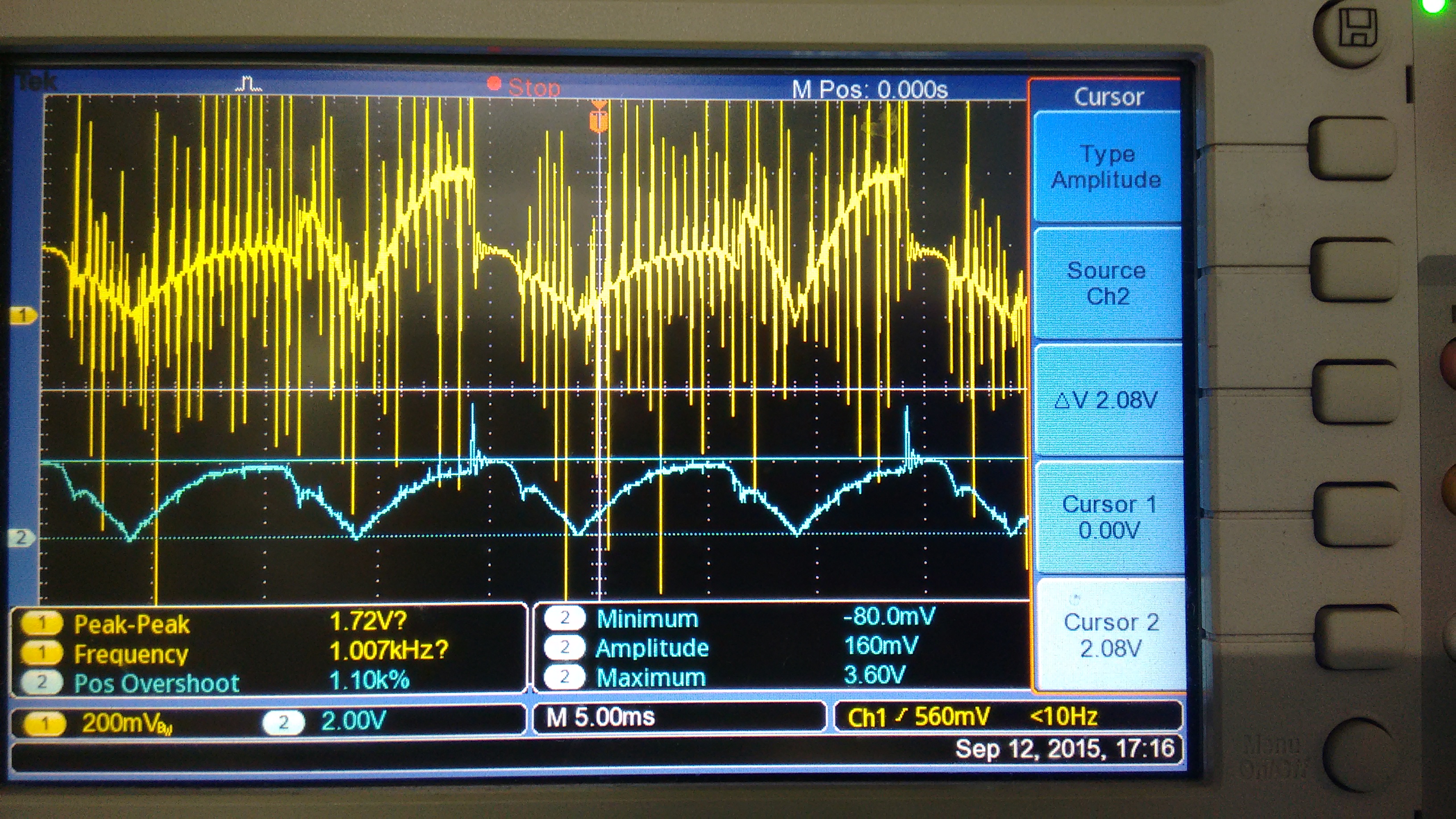

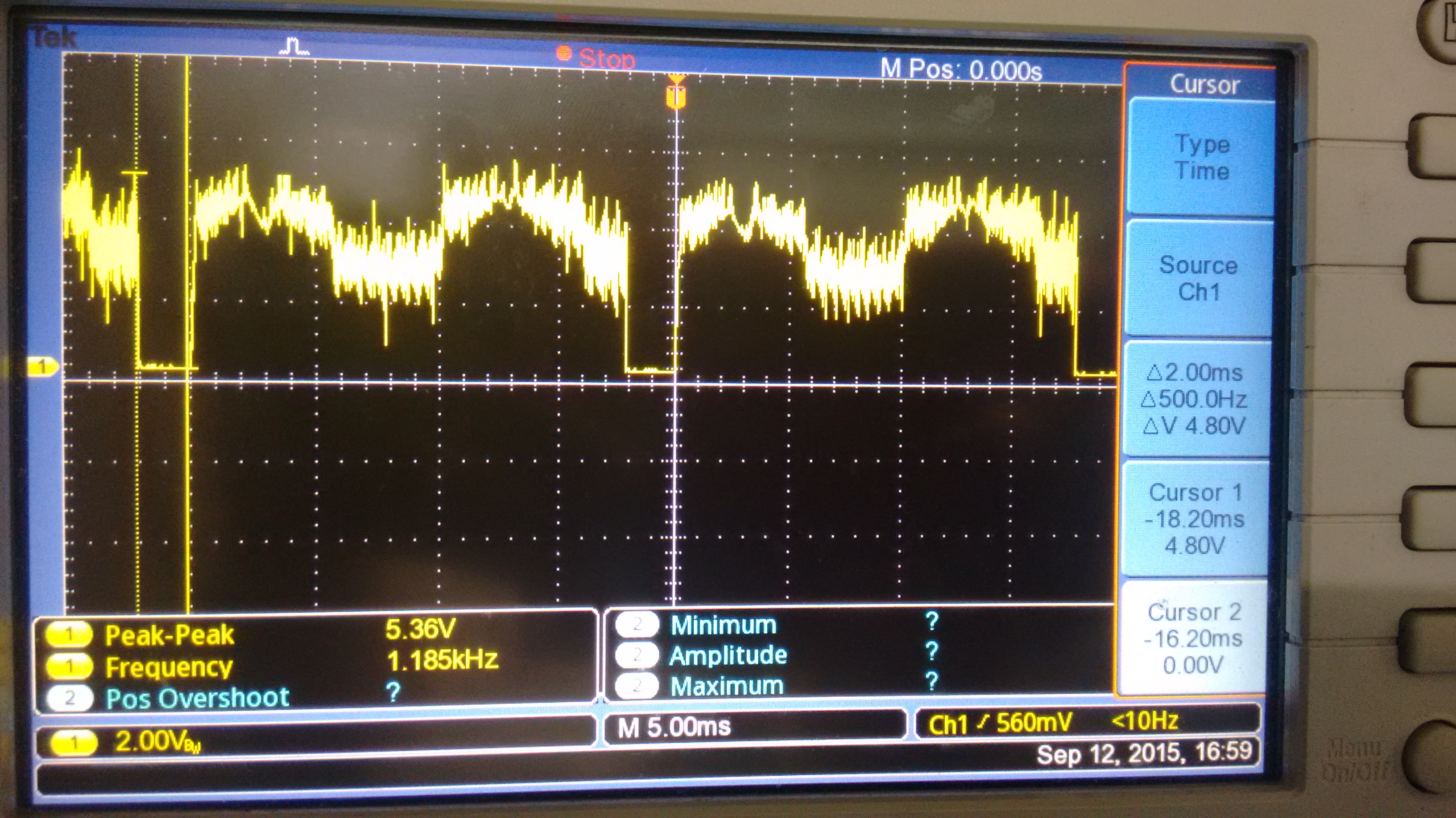

I am using UCC28070 in 3KW PFC application and i am facing problem like my pulses are tripping when i am testing at full load condition.Please see the below wave forms;
Below is the Current wave form at 220V AC: (CH1 shows current wave form and CH2 shows VAO wave form)
Below is the waveform at IMO pin:

I tried with different compensation values but not able to solve the problem. Can any one help me out to fix the problem.

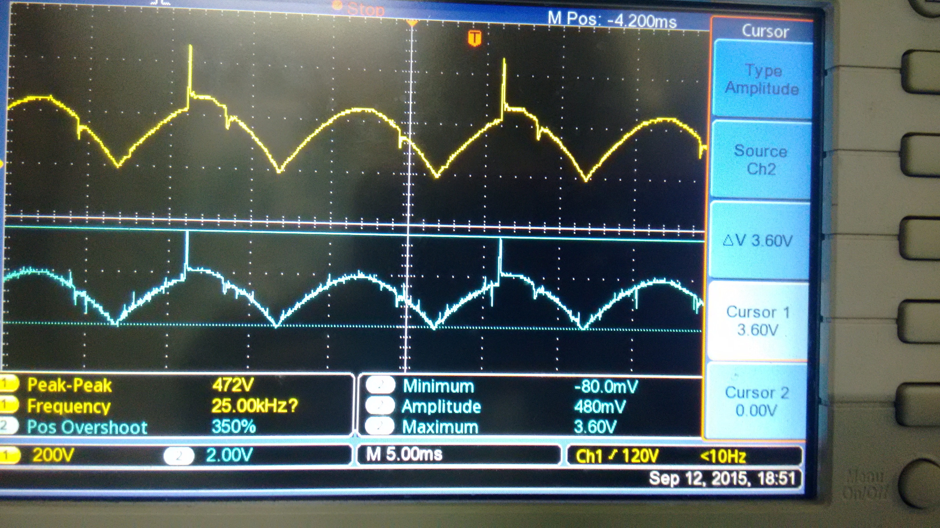

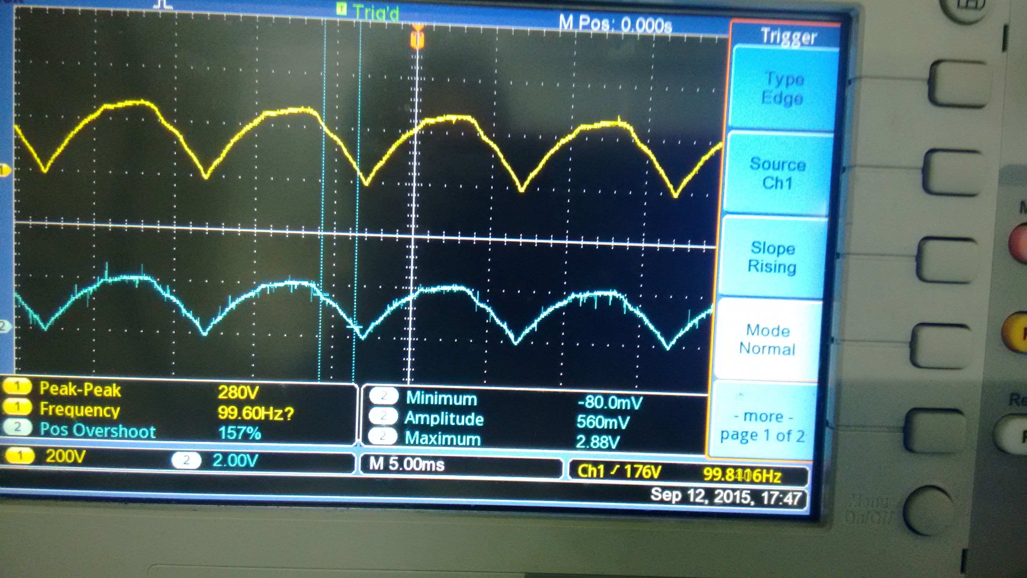

    Recently i found that above problem is starting when i am decreasing my input voltage from 230v (using variac). When i am decreasing the voltage below 220v problem was starting and some times it is recovering when i increased the voltage to 240 or 250v. Without variac I tested my unit at full load and it's working fine ( At the time of testing my input voltage is 235v).
    I found that when the problem was started there was a spike in input AC voltage and the same spike was appearing on the Vac pin also.
    Below are the AC wave forms :

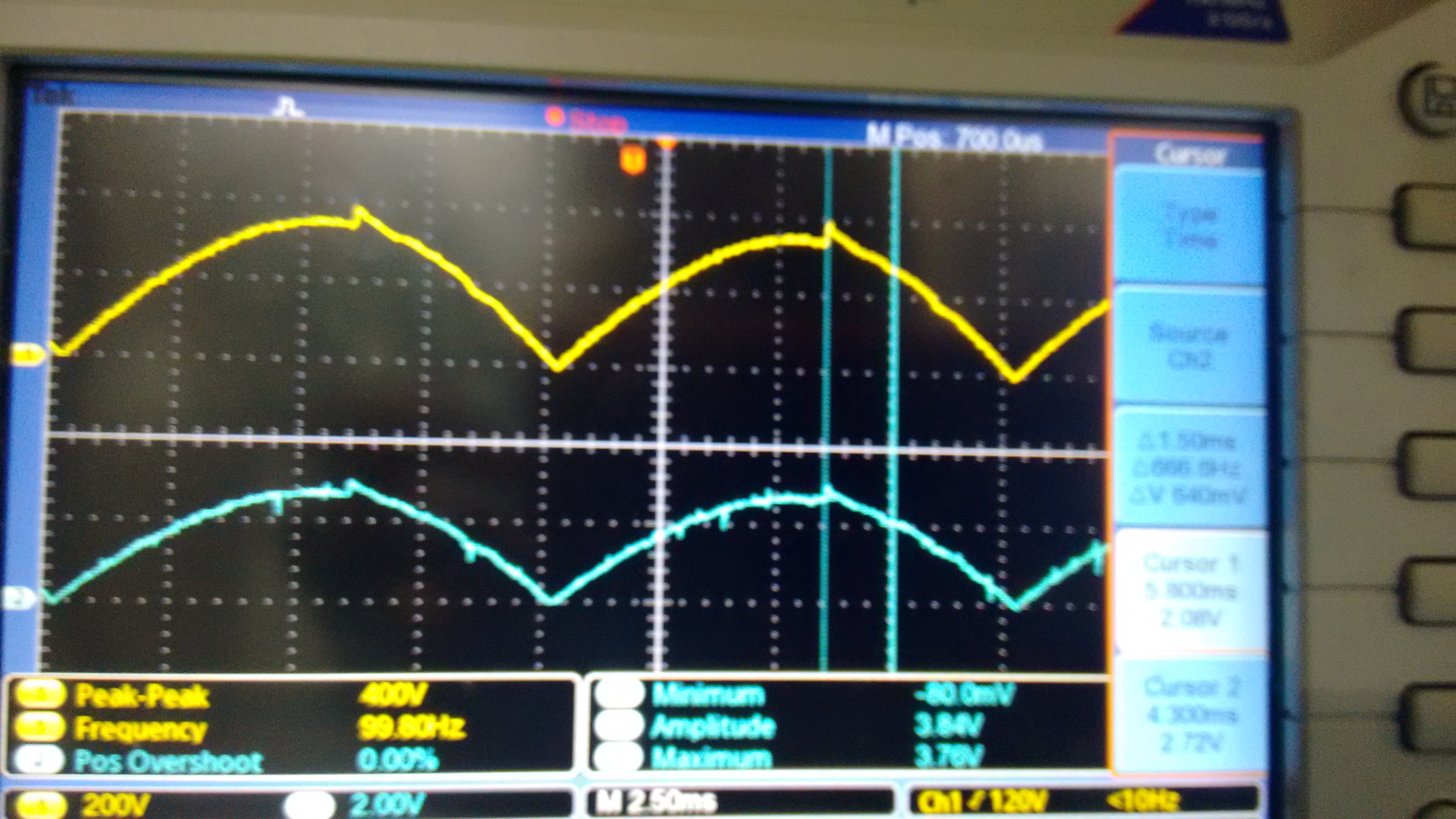

    Before problem starting : (Ch1: Mains AC and CH2: Signal at VAC Pin of IC)

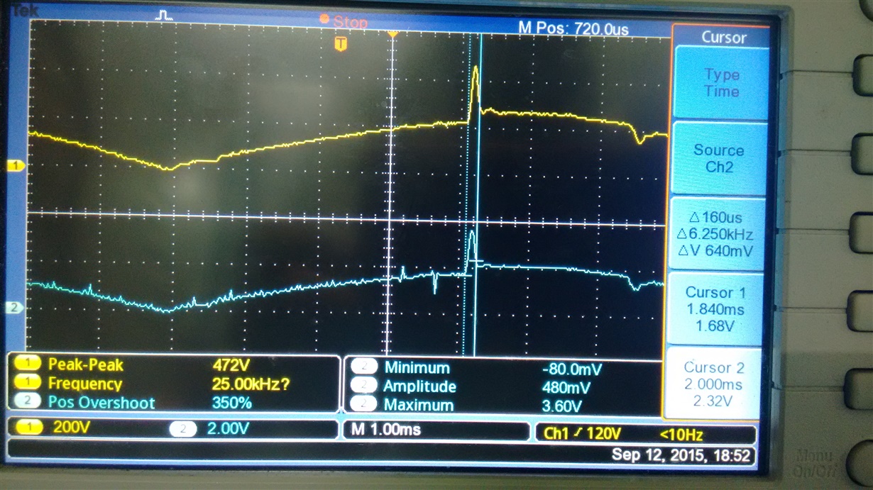

    After problem starting : (Ch1: Mains AC and CH2: Signal at VAC Pin of IC)
    From above waveform we can see the sudden rise in input voltage. I think it may be because of sudden change in current through inductive vatiac. But i am not getting why the gate pulses are suddenly tripping. My peak current setting was far away from the current sensing signals. And one more thing whey it is coming exactly at same location of AC wave form.

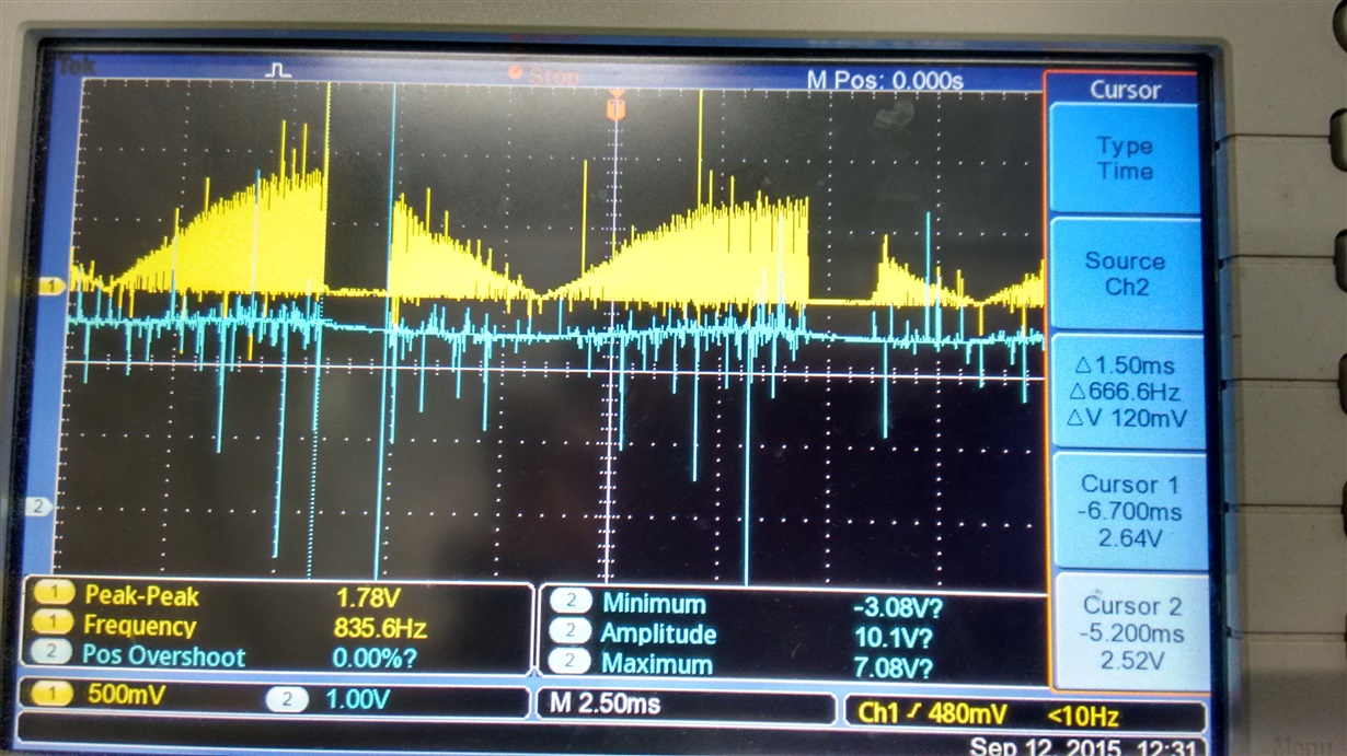

    After problem starting : (Ch1: Wave form at IMO pin and Ch2: Vac pin)

    After problem occurred i increased my input voltage and it's starts recovering but not fully. See the below wave form at increased voltage condition.
    And i also found that the problem is not coming when i loaded at 180v and increasing upto 230v.

  • I think you have found the source of the problem with the waveform on the VINAC pin.
    The UCC28070 has a quantized linear multiplier and this means it monitors the peak of the VINAC waveform and uses this block to set the gain of the voltage error block.
    Your circuit has a spike that causes the input signal to jump from about 2V to 4V for a time duration of about 200uSecs.
    This will cause the multiplier to mistakenly set the KVFF at the highest level. The reference signal into the current loop is now too low all of a sudden.
    The result is that the pfc circuit will not be able to maintain the output voltage setting.
    Its hard to tell from your first waveforms but it looks like your loop is going unstable and trying to recover.
    Can you please:
    (1) Recalculate the values for the VINAC resistors.
    For a 220Vac input, you need about 1.65V peak on VINAC. (You have about 2.4V)
    See Table 1 in the datasheet.
    (2)  Place a small filter capacitor on VINAC
    (3) Identify the source of the spike in your circuit and try to eliminate it.

    3. As i mentioned earlier the spike is because of sudden current changes in the inductive variac (to change my input voltages I am using variac) . But this sudden change in current was happening because of misbehavior in the PFC circuit (gate pulses are tripping suddenly). I think after gate pulses tripping only this spike is appearing on the input ac signal.
    We need to find out why this sudden tripping in gate signals are happening; it's because of problem in voltage loop, current loop or any other factors.
