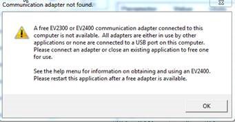

I am using a BQ76920 EVM, along with an EV2300.  The issue is that the BQ76920 utility does not recognize the EV2300.  I found the e2e link which provides 64b drivers for EV2300, but the same issue persists.
Is there a fix, or do I need to move to the EV2400?
I’m running Windows 7  64-bits.
Restart PC doesn’t help.
The provided link installed but problem is still there
       If you are running 64-bit Windows, see this link for 64-bit driver download:
         https://e2e.ti.com/support/power_management/battery_management/f/180/t/128220
When I follow instruction 2.2.1 AFE Quick Start Step10
I see
However, DeviceManager on my PC sees EV2300.
