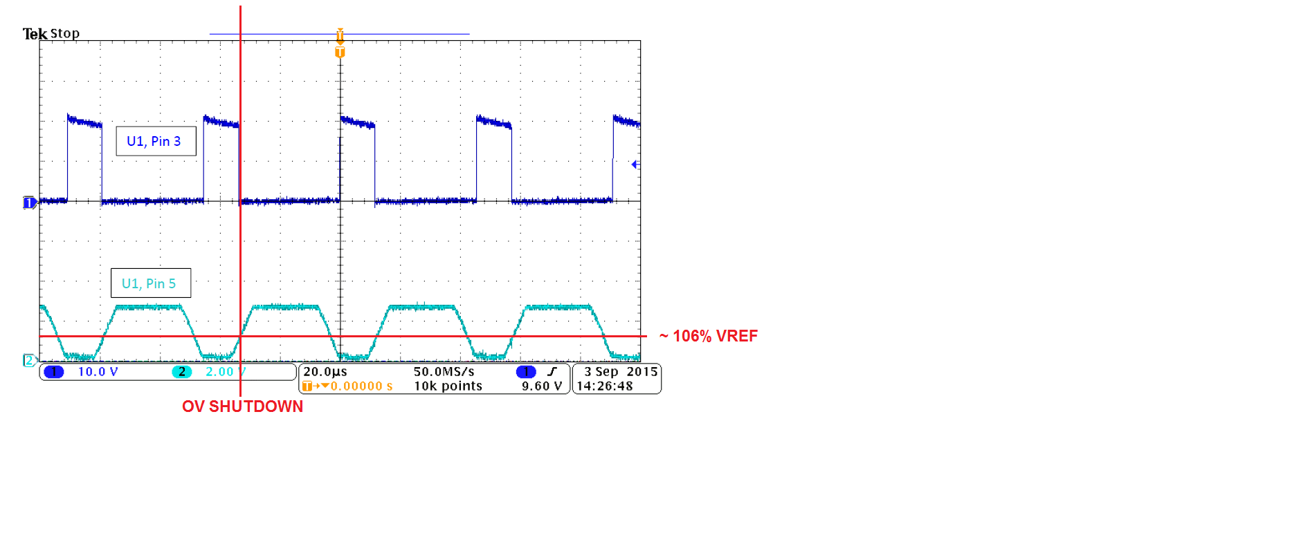

Has anyone successfully used the TPS54336 to make a current source?  I have built up the attached circuit but it refuses to work properly.  If I run it as shown (i.e. with C4 = 1uF), it produces close to the predicted current, but the switching frequency is only about 22kHz.  If I use a value of 250uF for C4, the switching frequency is correct, but I only get brief bursts of current.  The burst rate suggests that I am triggering the hiccup mode.

  • Hi Malcom,
    Here is what I found:
    1. U1 is supposed to switch at 340kHz, which should be a maximum 3us period at 100% duty.
      U1 is staying on for 12us, so something is wrong there, perhaps damage.
    2. The FB pin is being driven to 2.5V.
      The TPS54336 has OV overvoltage shutdown at VREF +6% (pg.9 of Data sheet)
      You can see this on the picture below:
    3. Also, we recommend using soft start (Pin 8) on TPS54336 (pg.13 of data sheet)
    4. There is a white paper (SLVA374) where TPS5160 (a very similar part) as used a current source. This is a very common method for driving LED’s, we have several designs.
    5. After sifting through several reference designs, I couldn’t really have a good example of what you are trying to do. The closest is the MSP 430 design (SLAA287) there they are using a discrete solution, rather than a buck converter. This paper might also be of interest.
    At this stage I highly recommend using one of our BQ series of battery charger ICs for what you are trying to achieve.
