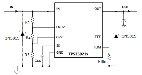

  I am using the TPS25921 efuse for my design . Css =1nF R1 = 680k R2=33k R3=68k Rilim=100k. A DC DC boost converter is connected at the output. This circuit works satisfactorily with the load without any problems.
But when I add a schotky diode in series with the input for reverse voltage protection, the circuit fails and the TPS25921 gets damaged (pulls excessive current from input or gives a constant output of 6V for all inputs >10V ).
What would could be causing the problem ? Why is using a schotky diode for input protection causing such a failure?
