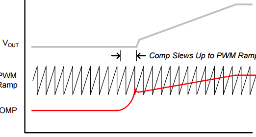

  • So far as I know, there is no internal delay. If there is, it is not documented.
    I do not have any characterization data over temperature. Just typical values as stated above.
    Current limit can affect start up time if the required current is above the current limit, SS will be delayed. If hiccup mode is entered, you may never start up.
  •  Also, for most voltage mode controllers, the PWM ramp does not start at 0V, so there's some delay while the COMP pin is charged high enough to enable switching. I've attached a graphic from another TI datasheet which illustrates this. This can be on the order of a few hundred microseconds, and it's controlled by the compensation design
