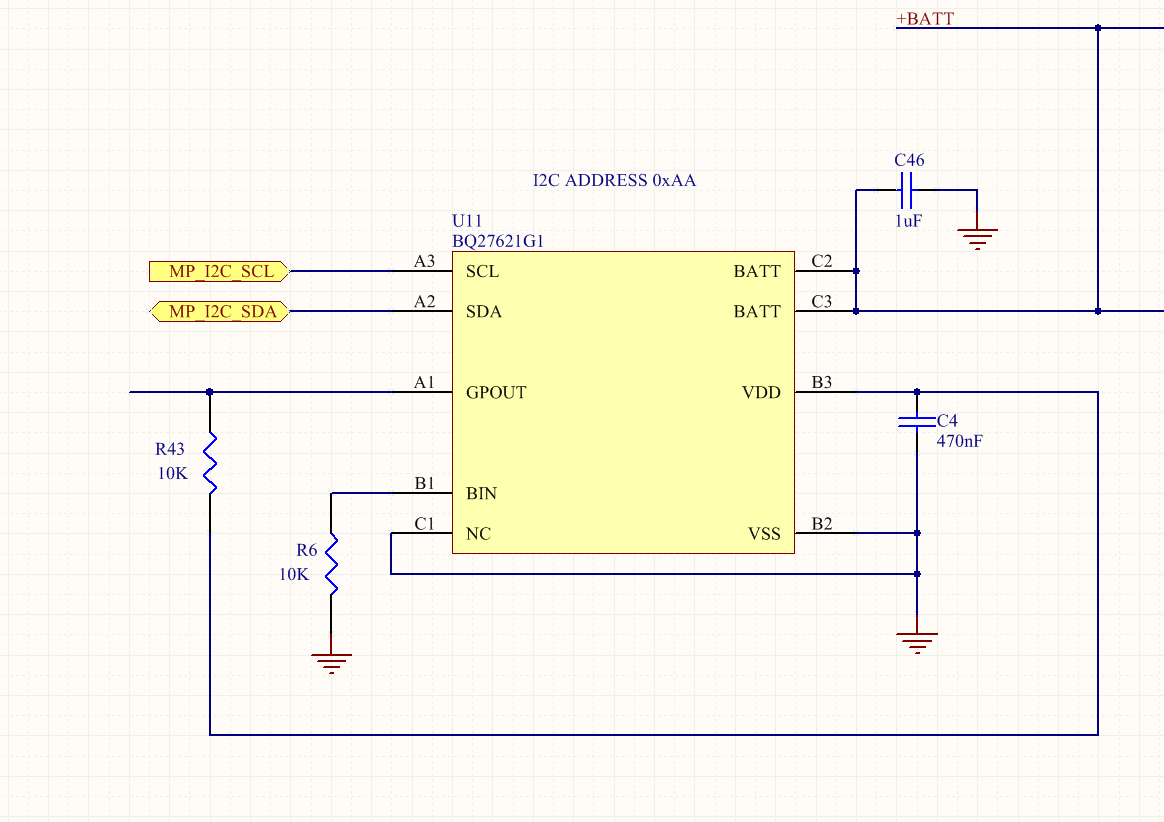

Hi there,
I am using the bq27621-G1 and I have seen that when the battery level goes low  or is discharged, the gauge returns always 0x00 for all requests and the SCK is always High.  If I do a hardware reset to my system it comes around.  And because its on a I2C Bus it is stopping all my program.  I am including the schematic of my project, although it is working properly when battery level is at normal.  Has anyone seen this behavior before, or is it normal
