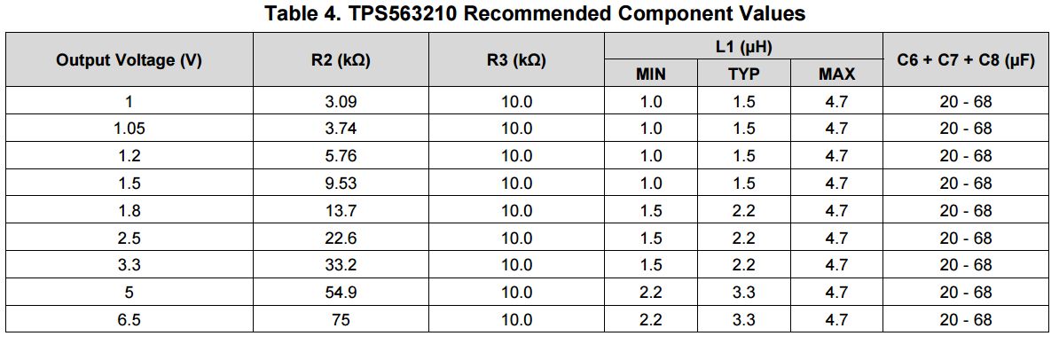

I know you recommend total output capacitor up to 68uF, but my customer want to use larger capacitor such as 100uF or 200uF. Then please let me ask following question.
  1. Can TPS562210 keep stability with larger capacitor such as 100uF or 200uF?
  2. Please let me know solution to keep stability with larger capacitor, for example adding feed forward capacitor
  3. Please let me know the concern due to larger capacitor, for example decreased stability, increased inrush current or extended soft-start time...
