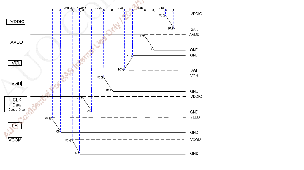

TPS65150 power-on sequence is ok, but our LCD also need power-down suquence, requirment as below.
If TPS65150 can meet this power-down sequence?
