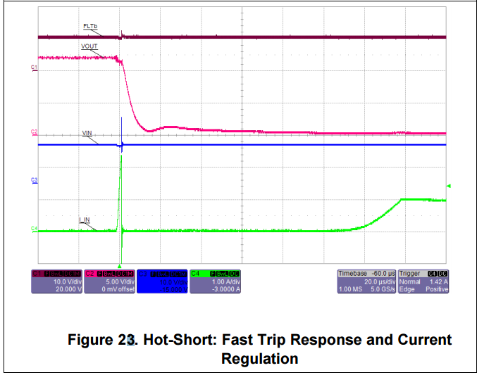

I'm simon, my application is 5V@ 350mA, need add load switch that OCP around 0.5A, and current limit response time under 500us.
please kindly have your recommend, thanks!

Hi Kaknevicius:
Thanks for your suggestion, but TPS22951 continues current spec:300mA.
Since my application continues current need 350mA.
Do you have other suitable solution that continues current spec around 500mA?
Looking forward your reply, thanks!
Hi Simon,
The TPS25921 should be able to satisfy your conditions. Here is a scope shot from the datasheet showing a very quick OCP response:
Let me know if this might work.
