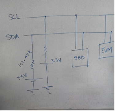

    2.  What voltage should I use to power the I2C ? I am planning to connect the two devices as shown in the image
    Is a voltage of 3.3 V sufficient / proper for our EVM ? and pull-ups of 47k. I plan to get this voltage from the BBB.

  • Regarding 1, standard I2C read and write commands, as explained in datasheet section 9.5, are used to read from/write to the charger's I2C registers. There are start and stop bits and the ACK bits on receipt.
    Regarding 2, the datasheet overuses the term "modes". The charger only operates in two "modes": charge or OTG boost. In charge mode, the charger runs in constant current "mode" until the battery voltage rises near VBATREG and then switches to constant voltage "mode". If I2C communication is available, the IC runs in host "mode" with certain default settings, otherwise it is in standalone "mode" with certain default settings.
