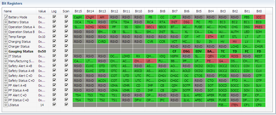

Here is a screenshot of the registers. Why both charge and discharge are inhibited

A hidden word had been cleared in your data flash and this disabled the FETs. I repaired it in the attached srec file. Be sure not to write to the data at address 0x495E.
Tom
