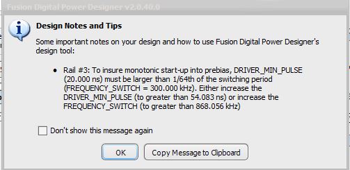

I have to reduce the frequency switching of UCD7242. This device generates the CVDD1 and CVDD1T for the TCI6638K2K SoC. I'm using the power configuration file from Advantech EVM. When I change the frequency switching in the Fusion tool GUI to 300KHz (the minimum allowed frequency) a message appears suggesting to increase the DRIVER_MIN_PULSE parameter. How I can modify this parameter? I'm not able to find it in the Fusion tool. In attach the warning message that appears.
