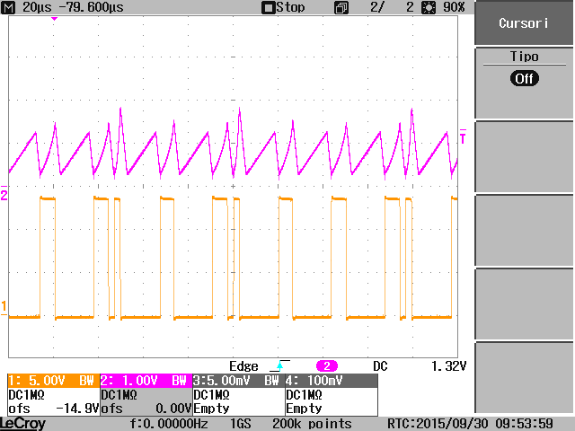

Hello Michael,
thank you for your reply.
The resistors are 5 because this is a topology that I use in many boards with different output current.
I'm just testing the dc-dc converter with a resistive load of 4,3 Ohm (Iout 770 mA about) with Rsense of 0,33 Ohm so Ipeak = 900mA.
I see an abnormal switching wave and a sawtooth wave on the timing capacitor (Ct). I report below the waveforms to understand better.
The Ct (fuchsia wave) has three different charge time so the ton is different each time for the transistor.
I think that the reason of this behaviour is the peak current limit to 900mA that modify the rise timing of Ct in the oscillator.
Which are your considerations about? Is dangerous use the Mc33063A in this way? It has also a Tcase of 70°C about.
You are right. When the current exceeds the "acceptable" current for the sense resistor, this will trigger the capacitor charge current to increase so that the current is limited.
This app note gives an excellent overview of the operation of the device: http://www.ti.com/lit/an/slva252b/slva252b.pdf
Even though the sense resistor is set so that it will trip with 900mA, the device is not perfectly efficient. If we assume 85% efficiency, which may be slightly high, then an output current of 765mA would be enough to reach 900mA on the input.
It is not dangerous to use the device in this way as it is this is the expected behavior based on the sense resistor. You could make the sense resistor smaller, and I would expect that you don't see this behavior.
As for your mention about the 70C. Is that your case resistance? Certainly thermal dissipation is important in any power design and needs to be considered.
This device is guaranteed to 85C, so it is not recommended to go above that.
Michael
