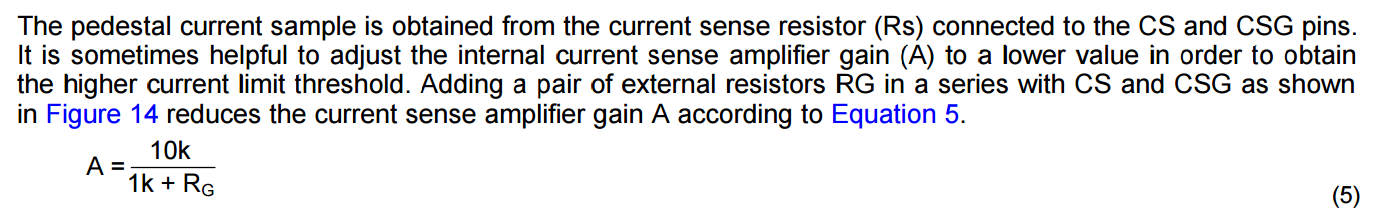

My customer would like to adjust  the current sense amplifier gain with LM25117.
There is the discription for the current sense amplifier gain adjustment on the datasheet P18 of LM25118.
Is it possible to adjust the the current sense amplifier gain with LM25117?
