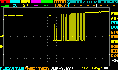

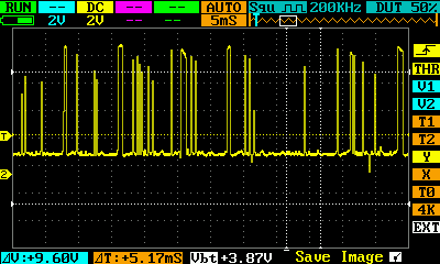

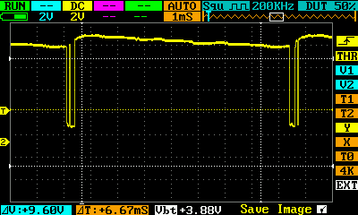

    I captured some scope traces of the gate waveform.
    It shows that before the pop occurs the gate is mostly high and after it settles to the expected short on time for very low dim levels.
    The gate is on most of the time before the pop on and the next two pictures zoom in on the  portion where it is switching.
    zoom in on the points where the gate signal is low which happens when the AC main zero cross......every 8.3mS
    The switching gate timing zoomed in more does not seem to be related to the Coff/ duty cycle of 250kHz
    After the pop, the gate line looks like this with no time where it is on for a long time.
