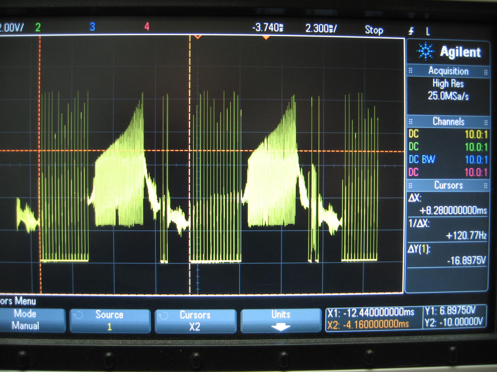

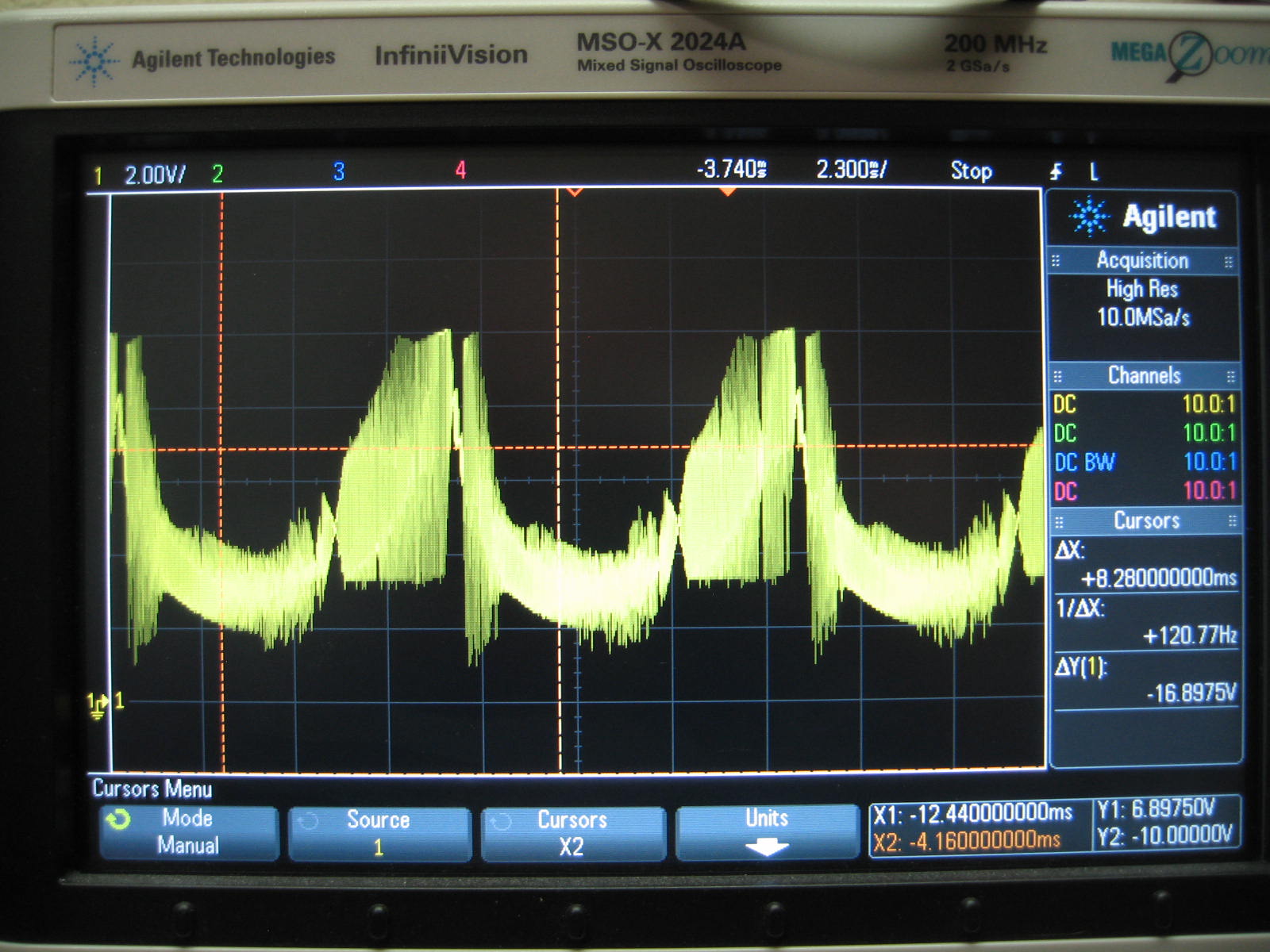

    Here are photos of the voltage waveform at the FET-drain / inductor junction on two LM3445 boards (A and B) that have identical components and are just slightly different in layout.
    The "Board A " scope trace (shown first below) shows the LM3445 on that board going into what appears to be ILIM protection mode (the pulses are exactly 180 usec apart) during the time that Vbuck is reaching its maximum.  The "Board B" trace (shown second below) has no such interlude.
    I have built two of the "A" boards and both exhibit the apparent ILIM behavior. But since the components are identical on the A anb B boards, I am trying to find the cause of the difference.
    Any ideas ?
    Benny Smith
  • If you are sure the components are the same, they are populated correctly on both, and that there are no trace routing error on either then the difference is most likely due to layout. Switchers require careful layout and any number of things could cause the part to think it is hitting current limit due to the noise generated. Sometimes it is something small (like running the current sense trace near or beneath the inductor) and sometimes it is something bigger (improper grounding). But if you would like to send me the two layouts to look over I would be happy to comment. Probably more than half the issues I see are due to layout.
