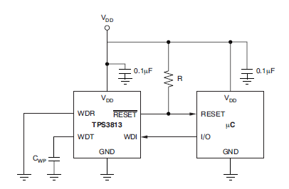

  • Hi Marcos,
    WDI cannot be disabled on TPS3813I50, however depending on your application's constraints you might be able to program the upper boundary. Using the following equation (1) from the datasheet you can calculate which CWP you can use depending on your flashing timing. Consider the figure below extracted from the datasheet:
    Given equation (1): twindow,typ = (CWP/15.55pF + 1) * 6.25 ms, and keeping in mind the that the maximum external capacitor you can use is 63 nF, you can have up to a twindow,typ of 25.32 seconds, or twindow,min = 18.99 seconds (for more details refer to page 9 of the datasheet)
    This might be helpful because as described in the datasheet, "After the reset of the supervisor is released, the lower boundary of the first WDI window is disabled.", providing you with that window time to perform your operation.

  • Hi Victor,
    From your example using the 63nF cap, that Flash-programming operation of my ECU's Microcontroller be completed under 18.99s, once reset of TP3813I50 is released. Is my understanding correct?
    Thanks for your patience in replying to my queries!
    Best Rgds,
    Marcos
  • Hi Marcos,
    Yes, the flash-programming operation of your ECU's micro-controller should be completed under 18.99s after /RESET is released and start pulsing WDI, otherwise if WDI receives no pulse during this amount of time /RESET will be asserted.
    Victor
