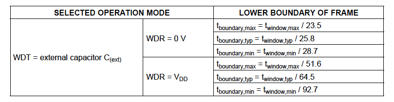

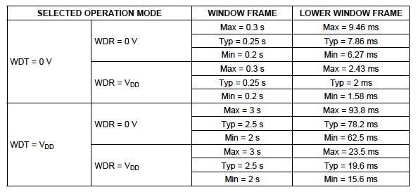

    Thanks, but I still have a question about the tolerance of the window frame, why 25% tolerance for max & min which shown in datasheet page9.
    max=1.25*twindow、min0.75*twindow. Is it means the external capacitor or TPS3813 internal tolerance?
    Meanwhile, can you tell me directly that can I use 68nF capacitor as our application for min 20s long delay time?
    Thank you so much
  • Hi Jackie,
    The ±25% variation of the part itself, and it does not take into account the variation in the capacitor you might use, also, we do not recommend going outside of the specified CWP value range (i.e. 155 pF ≤ CWP ≤ 63 nF).
