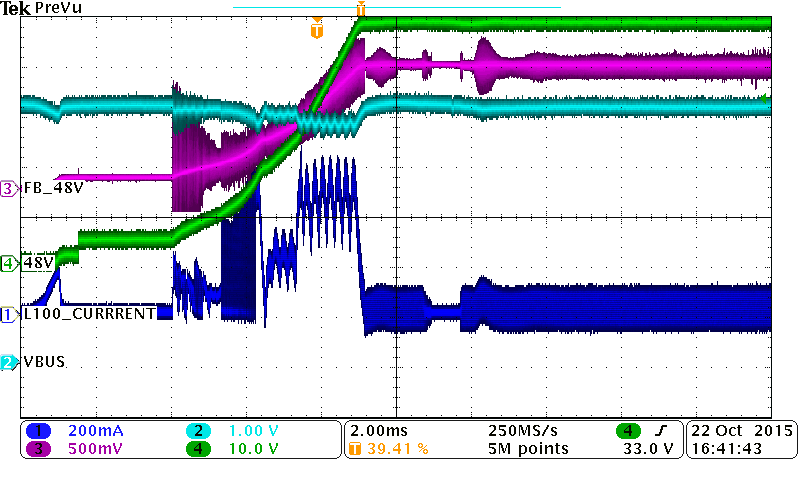

  • Hi Helen,
    Here are a few scope shots of my 48V regulator circuit.  The trace labeled VBUS is the 5V input, connected, via T4, to both VIN and CTRL of the 61170.  FB_48V is the FB input to the 61170.  L100_CURRENT is a current probe measurement taken at the output of the inductor.  48V is the output of the regulator circuit.
    As you can see, the 5V input drops from about 5.2V to about 4.5V as the 48V output ramps up.  Although not shown in this trace, we also see a surge of about 400mA on L100 and a drop of about 0.5V on VBUS every time the 48V output is muxed onto a load.
  • Hi Danold,
    I noticed the input voltage has a big drop or (oscillation) during the  start-up. This is usually caused by the long and thin input wire. Please try to use a much thicker and shorter wire, it will be helpful.

  • Hi Donald,
    From the spec, for the first 5 msec after the COMP voltage ramps, the current limit of the PWM switch is set to half of the normal current limit specification or below 700mA (typical). Form your experimental result, I noticed that the peak inrush current is about 600-700mA. So it is a normal phenomenon.
    From your schematic, I noticed that you already add an inrush  current limit circuit: T4+R138, so you can limit the inrush current by control the timing of the t4's turn-on time, before the output voltage reach a certain value, t4 keeps turn-off, all the current flow through r138. Make sure the power rating of R138 is OK during the start-up.
    So you need to spend some time on experiment to make a judgement on when the T4 should be turn-on and the R138 selection.
