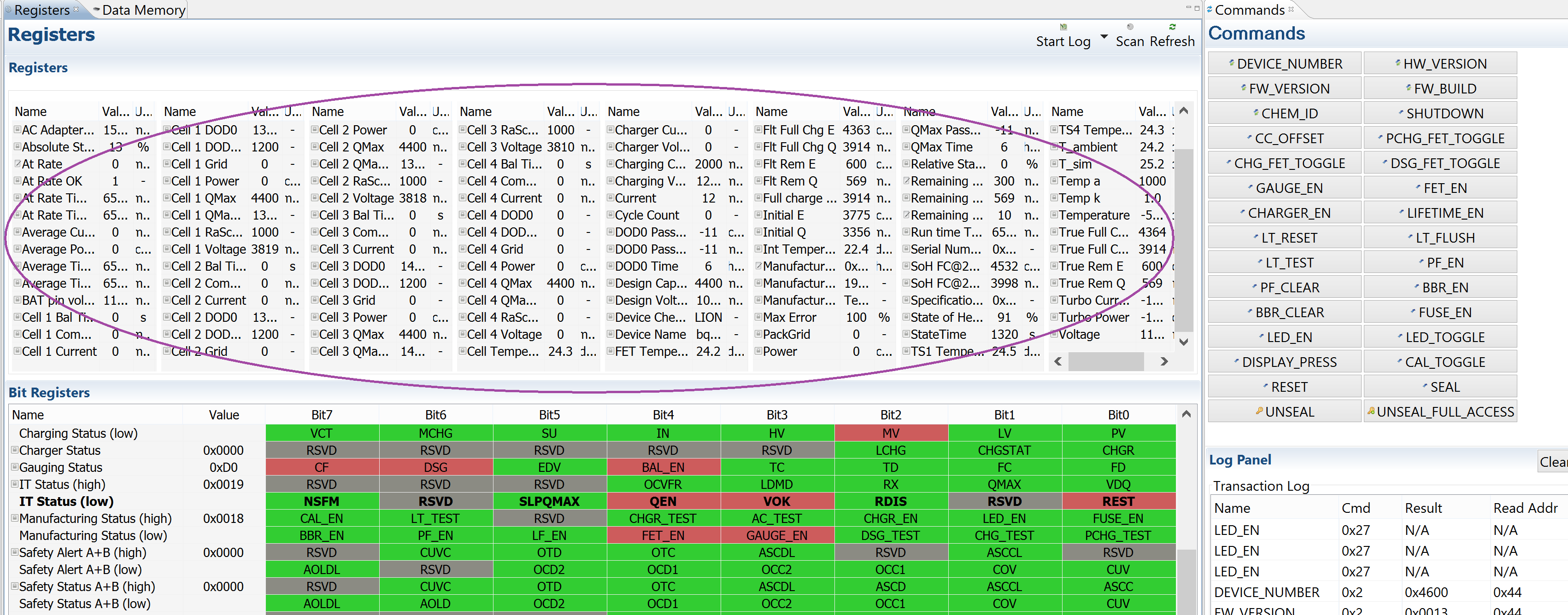

I just got bq40Z60 EVM and EV2300,  also installed the bqStudio. Everything looks fine, but only the Registers display info seems mess.  The info are squeezed sticking together, it is not allowed me to adjust the display width. It is not convenient for me to read the registers' content. Is there anyway to fix it?Can anyonw help?

  • Try reducing the font. Go to Windows >> Preferences >> Registers - Font
  • Thanks Thomas! It works.
