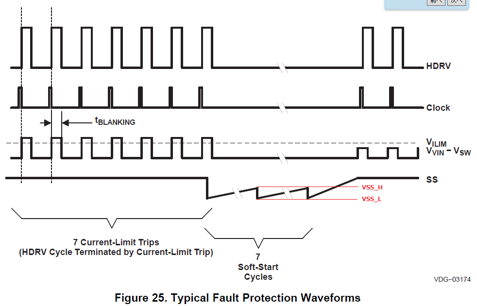

Hi Team,
Could you tell me the following threshold voltage of VSS_H and VSS_L when short-circuit protection occur?
(datasheet page.19)
My customer wants to know it to calculate the duration of "7 soft-start cycles".
Your support would be appreciated.
