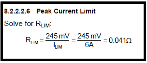

    I have connected 6 LEDs series. One LED current is 1A. So the LED string current is 1A since 6 LEDs are connected in series.
    When we look into the equations, there are two parameters:-
    1) Average LED Current. Please let know how Vsns = 100 mV ?
    2) Peak LED current.
    Here why we need to consider ILIM as 6A even though we didn't connect the LEDs in parallel ?

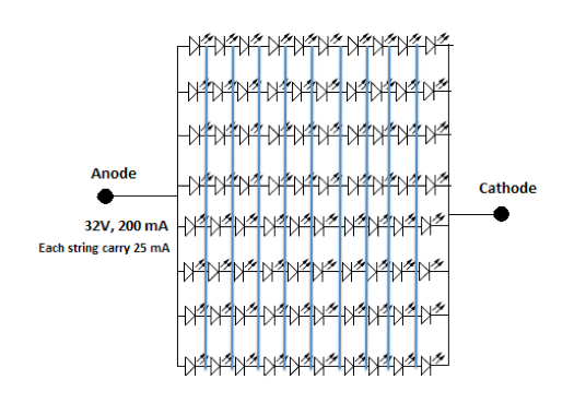

    Also for below configuration what will be the ILIM ?
    Above ILED is 25 mA
    What will be ILIM ?
    Azlum
  • Hi Azlum,
    It depends on the input voltage and output voltage relationship if they are in a boost configuration.
    For instance, if your input voltage is at 6V and your output voltage is at 36V, the boost ratio is 6.
    With such boost ratio, your MOSFET needs to get current 6 x your targeted output current.
    Therefore, the ILIM should be set at 6 A.
    The above just illustrates an ideal calculations.
    In actual designs, you need to get some margin for this current limit.
    So, if your boost ratio is at 6 and targeted output current at 1 A, it is suggested to set current limit higher than 6 A (say 6.6 A).
    With your 200 mA examples, it also depends on the boost ratio.
    I would suggest a current limit of (200 mA x boost ratio + 10 ~ 15% margin).
    Issac.
