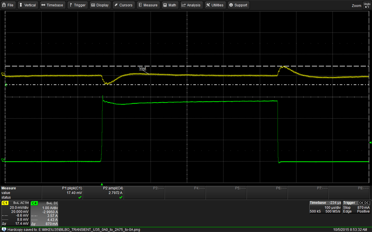

I am using a TPS51200 to get 0.75V out from 3.3V in. The max load is 0.25A. When I was checking the rail I noticed the transient does not look like what I see in the datasheet. What could be the cause of this?
The attached transient shows 0mA - 60mA transient. The ac response I see shows the signal swinging from negative to positive. Please advise.
Thank You,
