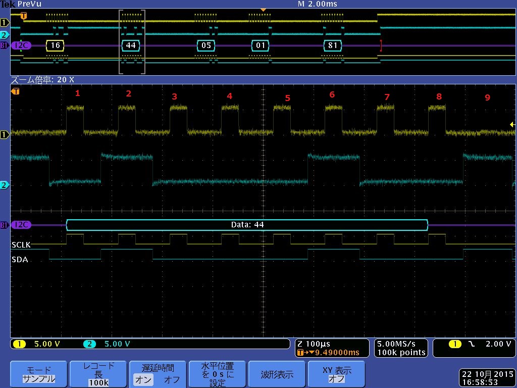

I want to make the C# software to perform the calibration.
But I have issue SMBus ManufacturerBlockAccess().
(The communication we are using MPSSE mode of FT232H of FTDI chip.)
FT232H the in connection with BQ40ZR1, when I send the 0x44 command to write data, It lost the ninth clock of 0x44.
In 0x00 ManufacturerBlockAccess () does not occur.
What should I do In order to communicate properly?
