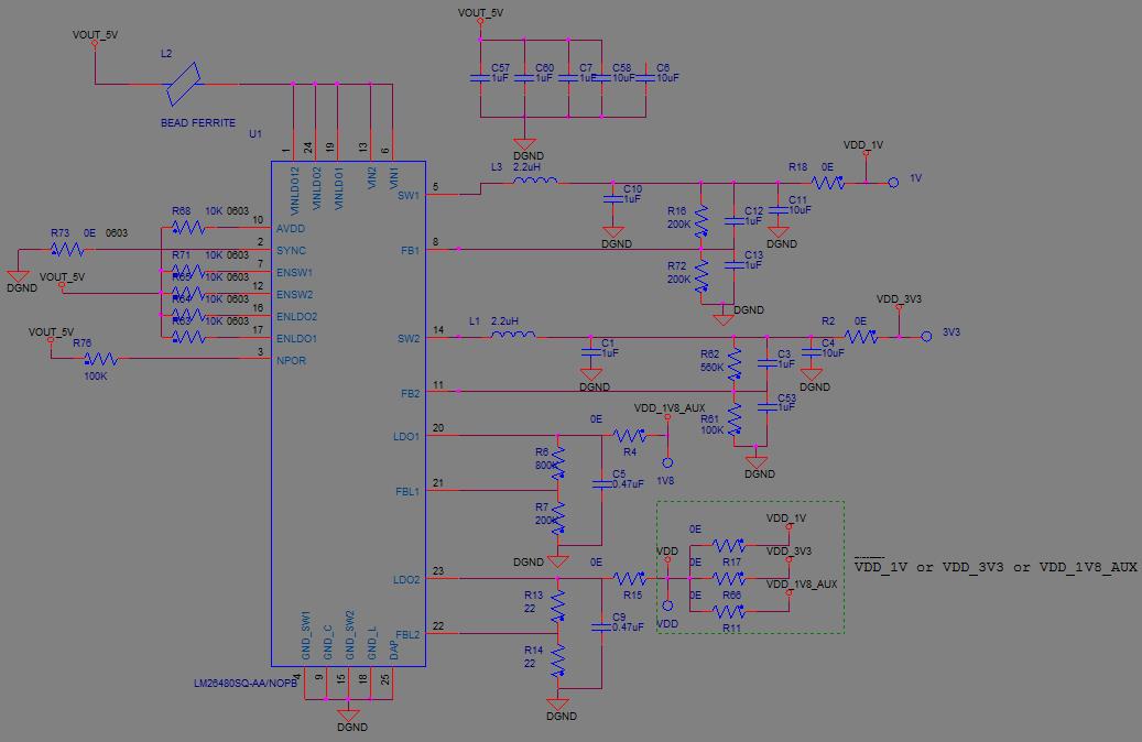

OUTPUTS ARE NOT AS EXPECTED IN LM26480
Other Parts Discussed in Thread: LM26480
I am using LM26480 to derive 1V,1V8 and 3V3 outputs for FPGA.The schematic is made with reference to the LM26480EVM schematic.But i am not getting the expected outputs and i am getting 5 Volt at the output side.request you to give the suggestion to this post.
