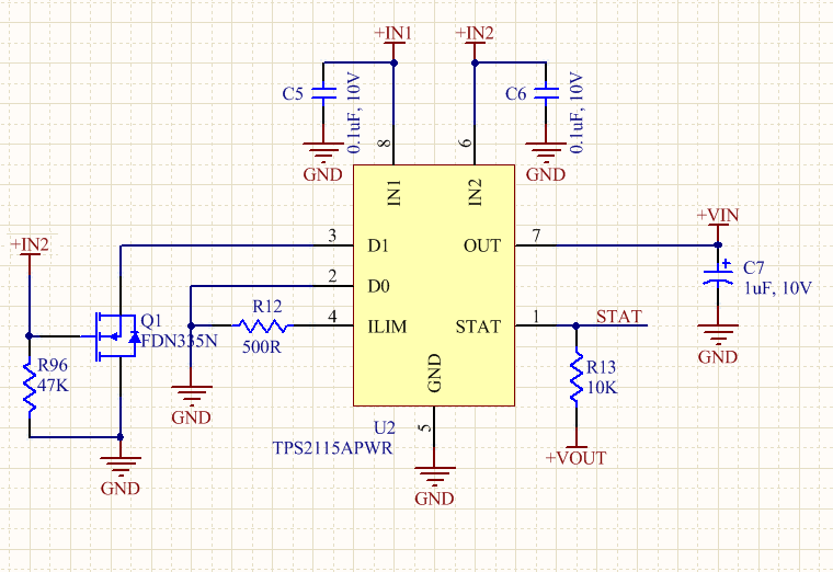

TPS2115A - Manual switching mode
I have this system and i need autoswitch and USB is connected, solar panel it's always connected.

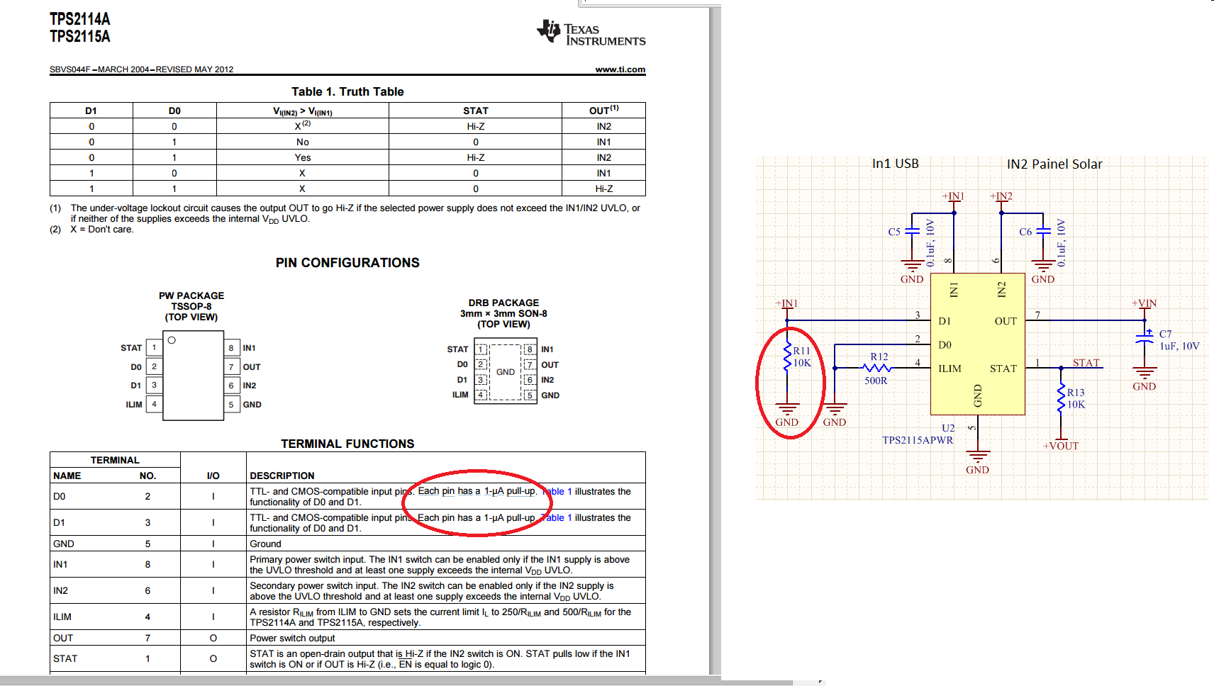

So i designed this way, but i think its not work because D0 and D1 its internal pull-up.
And i modify the circuit for this, and change +IN1 to Solar Panel and +IN2 to USB, this approach it's work or there is another way to improve this?
