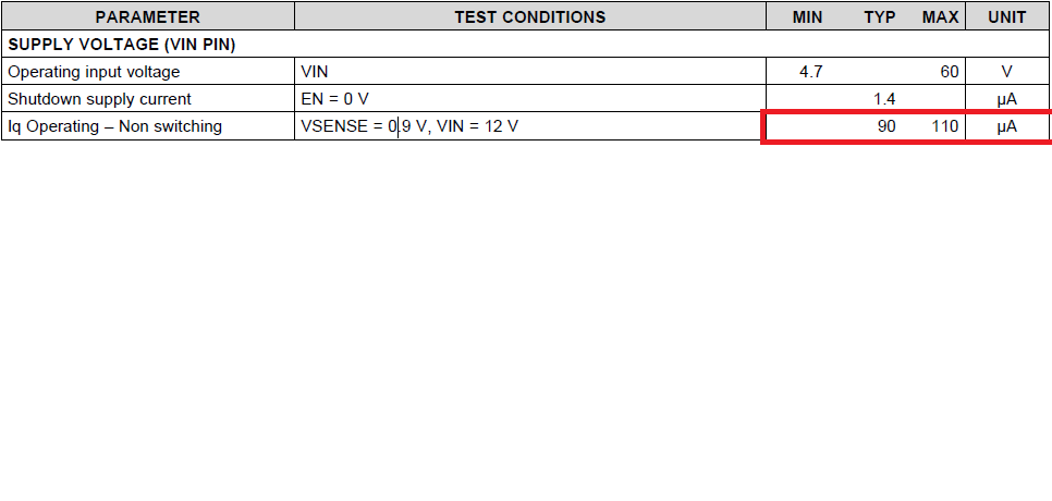

TPS54061DRBR questions
                  Customer input VIN is 12V and VSENSE 0.8V. But the power consumption is 246uA. It is still larger than below red mark power consumption. What is the major root cause for it? What is test method and condition for below red marked power consumption? Thank you.
