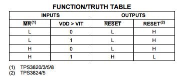

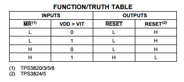

TPS3825-33 / RESET output below 1.1V
I know that /RESET output is undefined below 1.1V, then is RESET output also undefined with /MR=Low? Or does it keep Low state?
